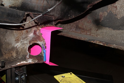

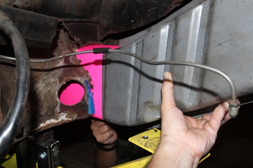

Puzzled over how to match up the inner long to the wheelhouse long, decided on a similar process. What you will not see in this series is me levelling the car across the little ledge in the firewall and constantly measuring the door gaps. I'm checking these at intervals as I go.
Made a template to represent the inner long. It's taped to the body. I've mode some witness marks on it so that I can remove it and then put it back in the same place.

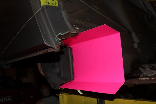

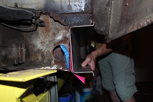

Put the wheelhouse long in place...
...and traced the edge on the template.

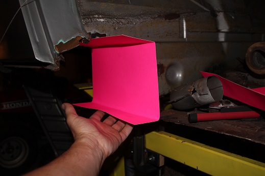

Removed the wheelhouse long.
The template is then removed, cut on the traced line, and then replaced using the witness marks.

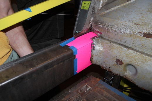

Then I put the inner long in place over the template.

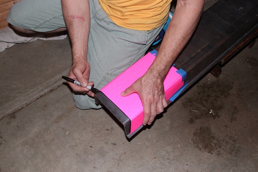

Taped the template to the inner long.
Traced it and cut. Cut outside the line a bit so I have a little room for adjustment.
