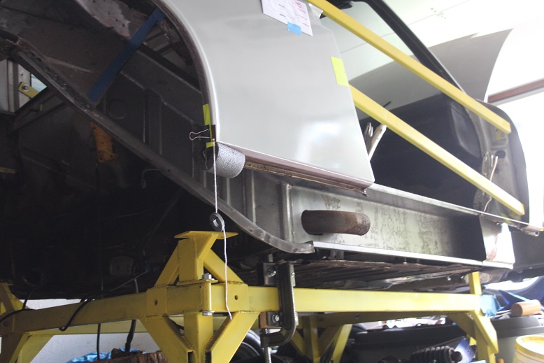

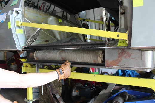

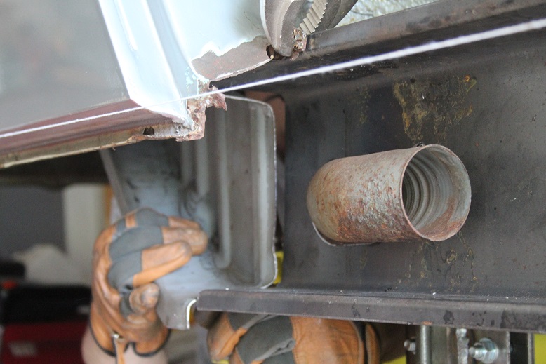

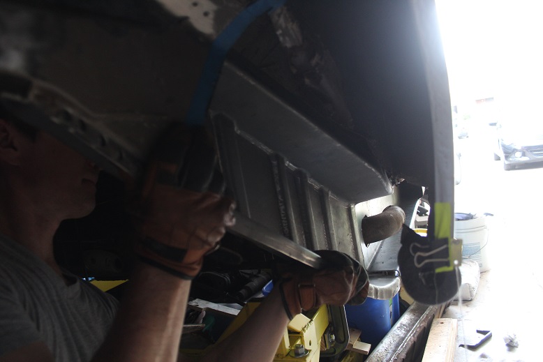

Test fitting the heater tube.
Going to need a little adjustment work to get all this fitting together.
I just like this picture.
I'd be lying if I said I wasn't a little excited to see all this healthy metal so close to being in the car. A good strong backbone again.
