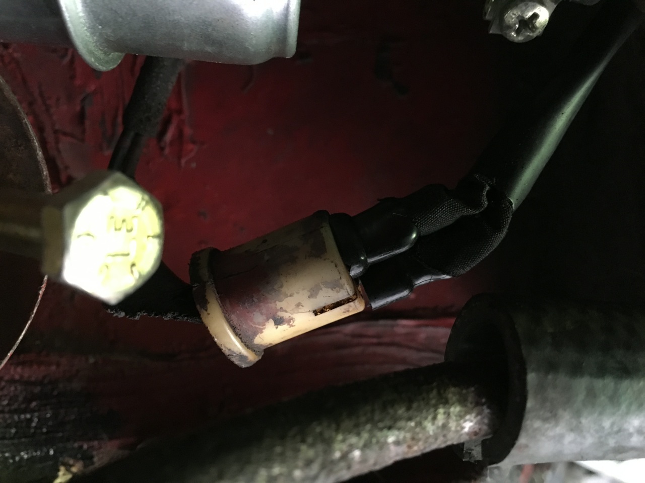

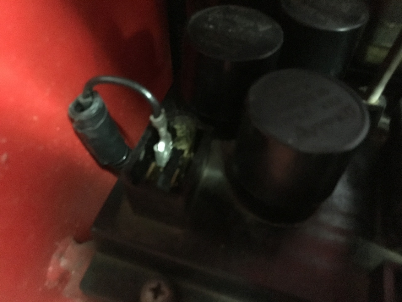

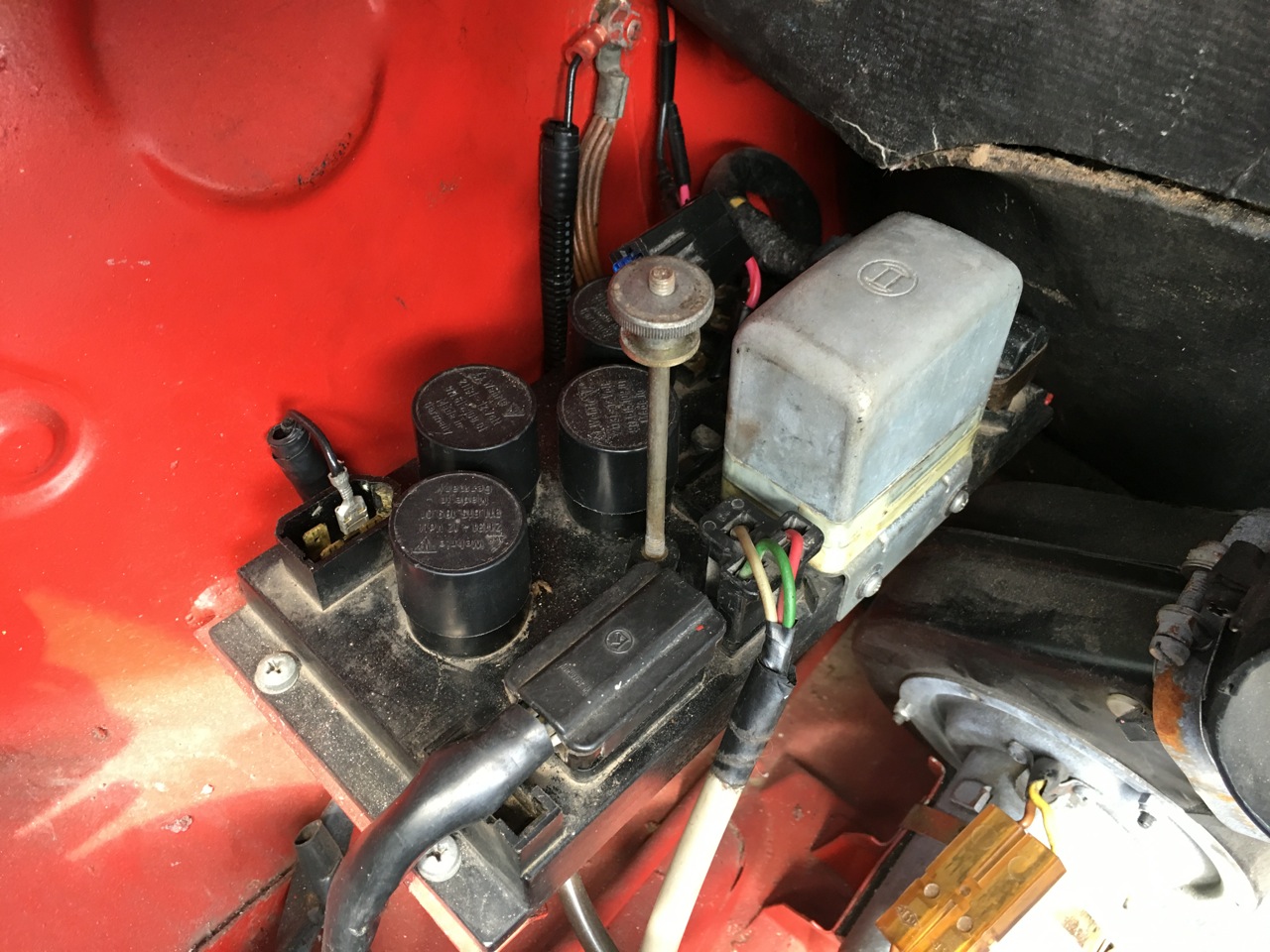

installed a jumper to fool the fuel pump relay.

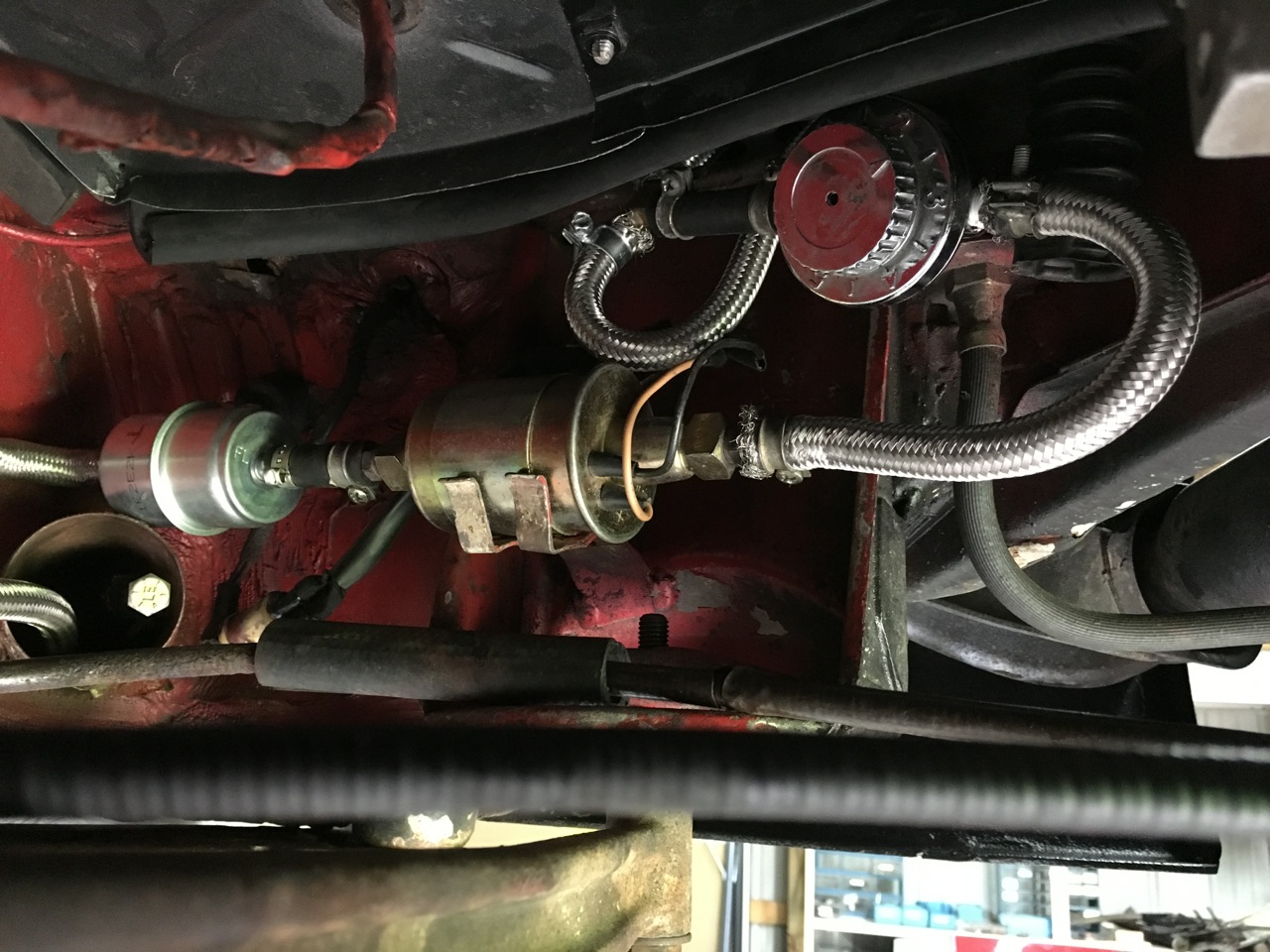

Fuel pump and filter. Regulator also set at 2.5psi. First pump I installed failed, so had to route this twice.
Also jumper to the 12 volt plug.

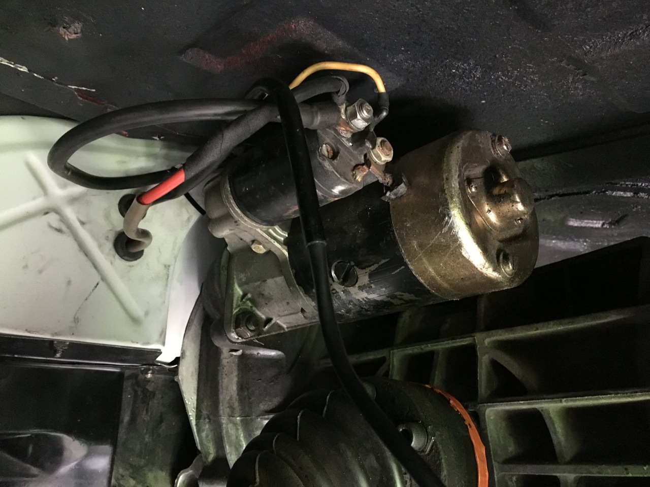

Starter wired up.
Finish up the cables and a few other things Ill be set to go.
