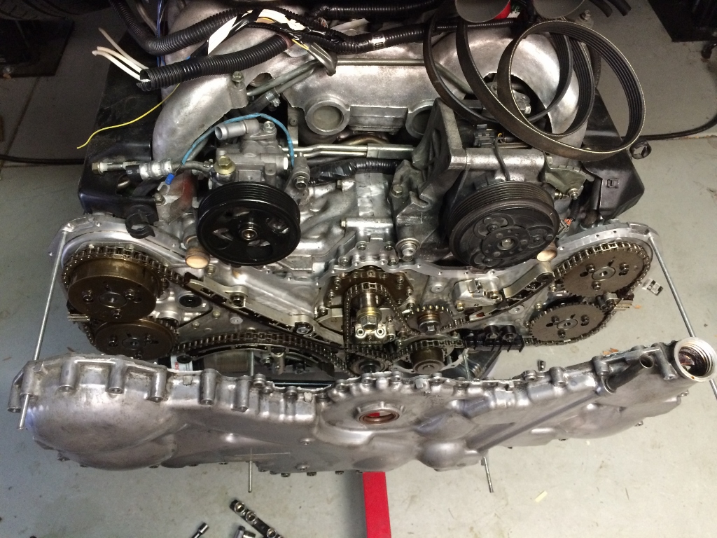

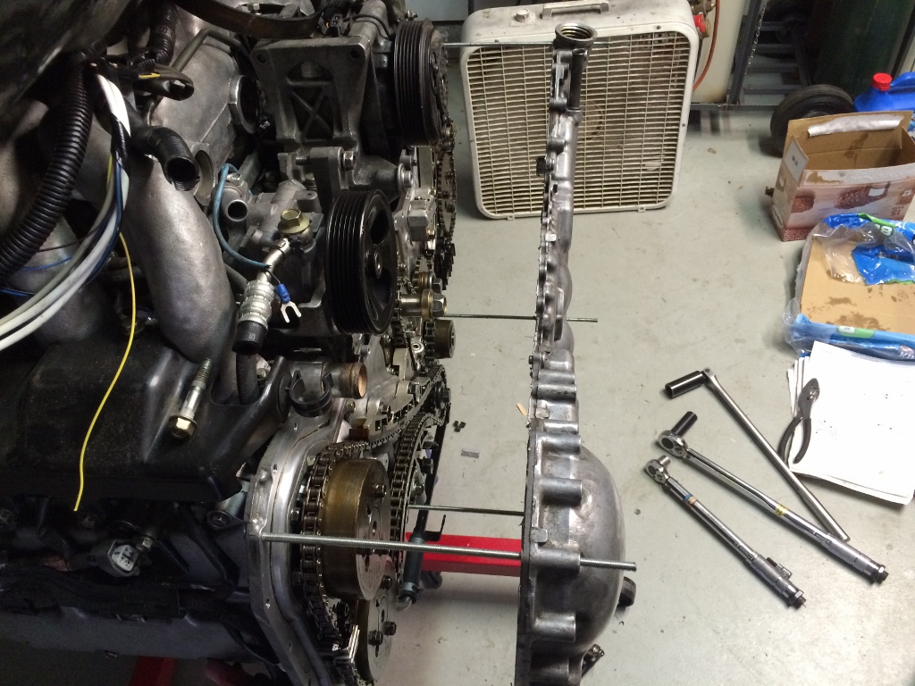

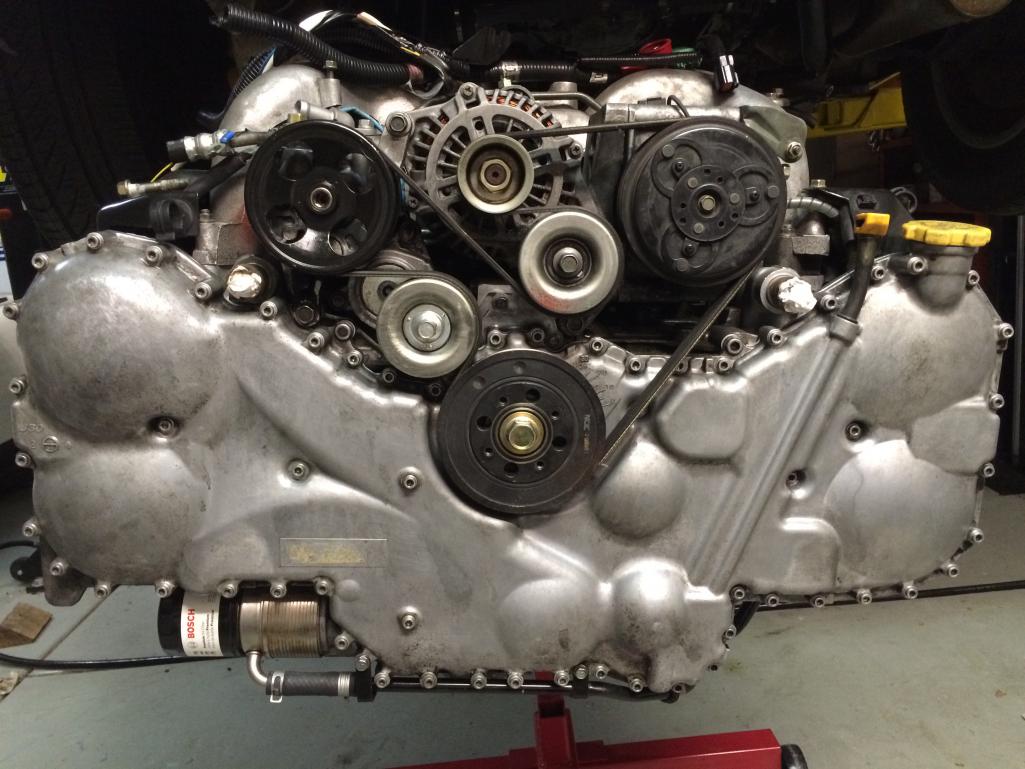

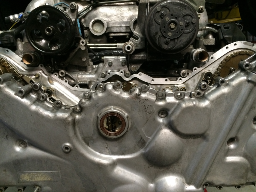

Whew! That was a blast. Not! (IMG:style_emoticons/default/evilgrin.gif) But it's behind me now and I learned a few things along the way. I filled it with oil tonite and NO leaks. (IMG:style_emoticons/default/piratenanner.gif) The threaded rod was the ticket. Heres a few shots of the front cover being installed.
