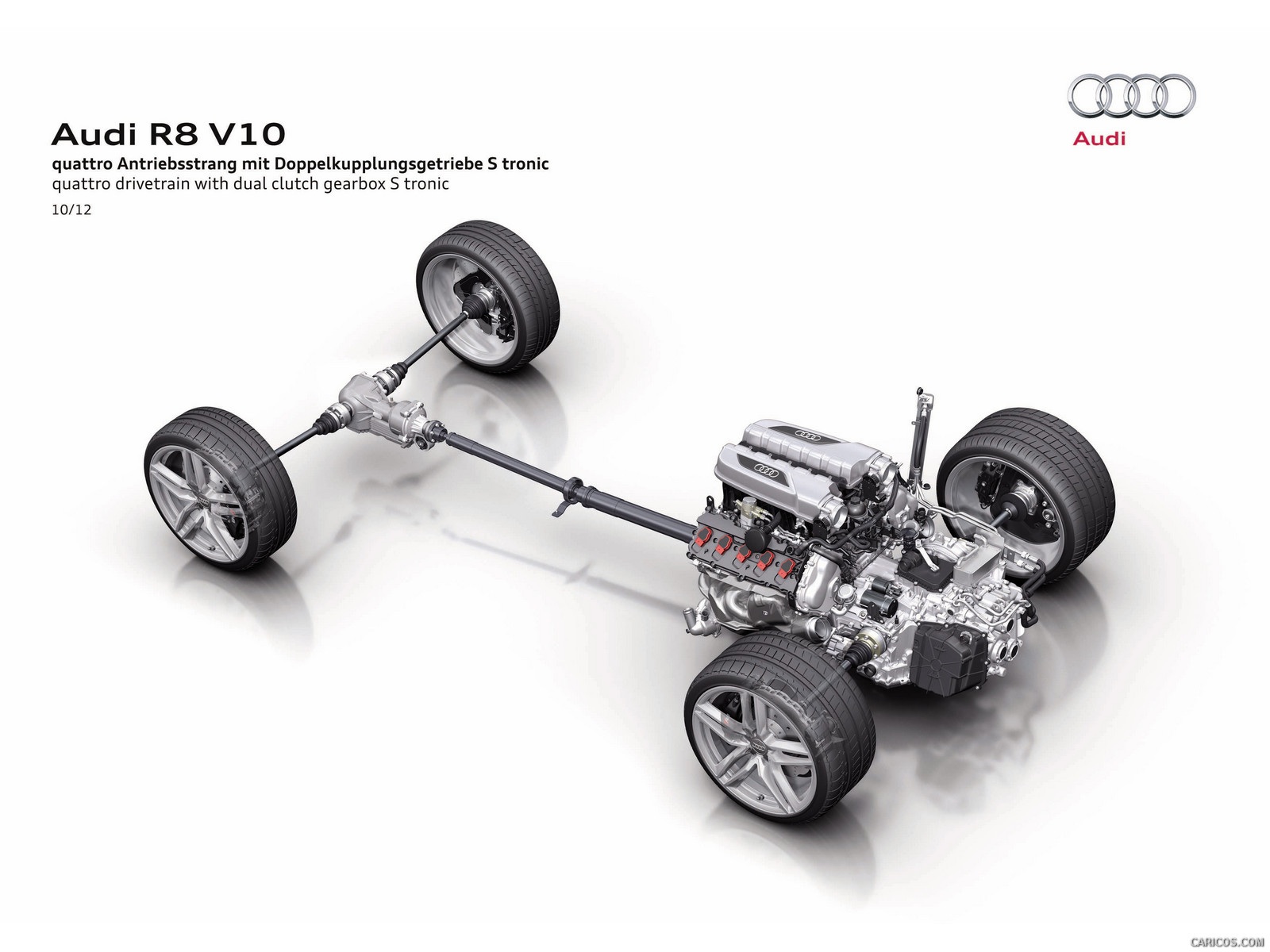

Here's what you should do. (money no object)
Find a wrecked R10 or R8 with a PDK and make an AWD 914.
