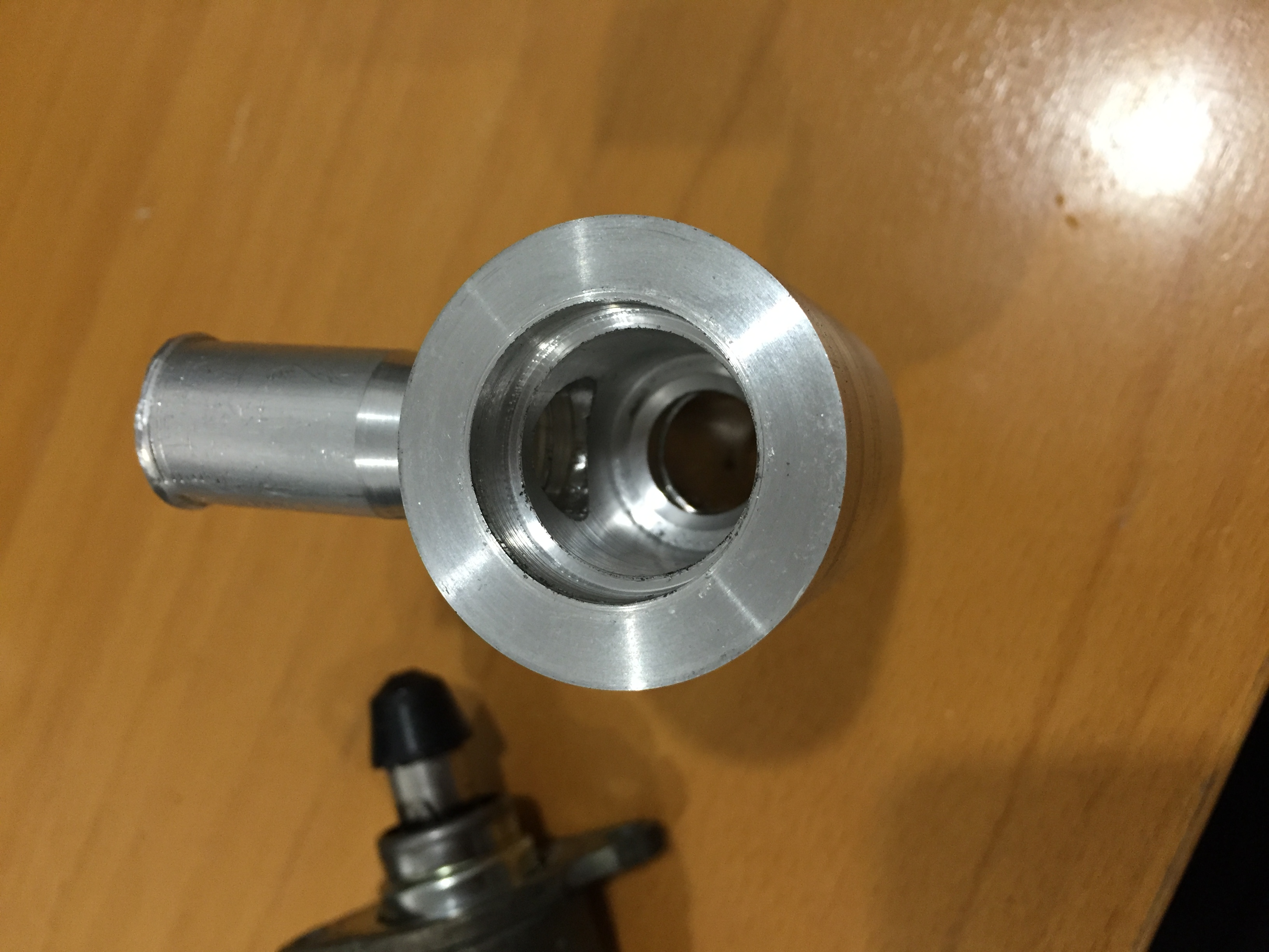

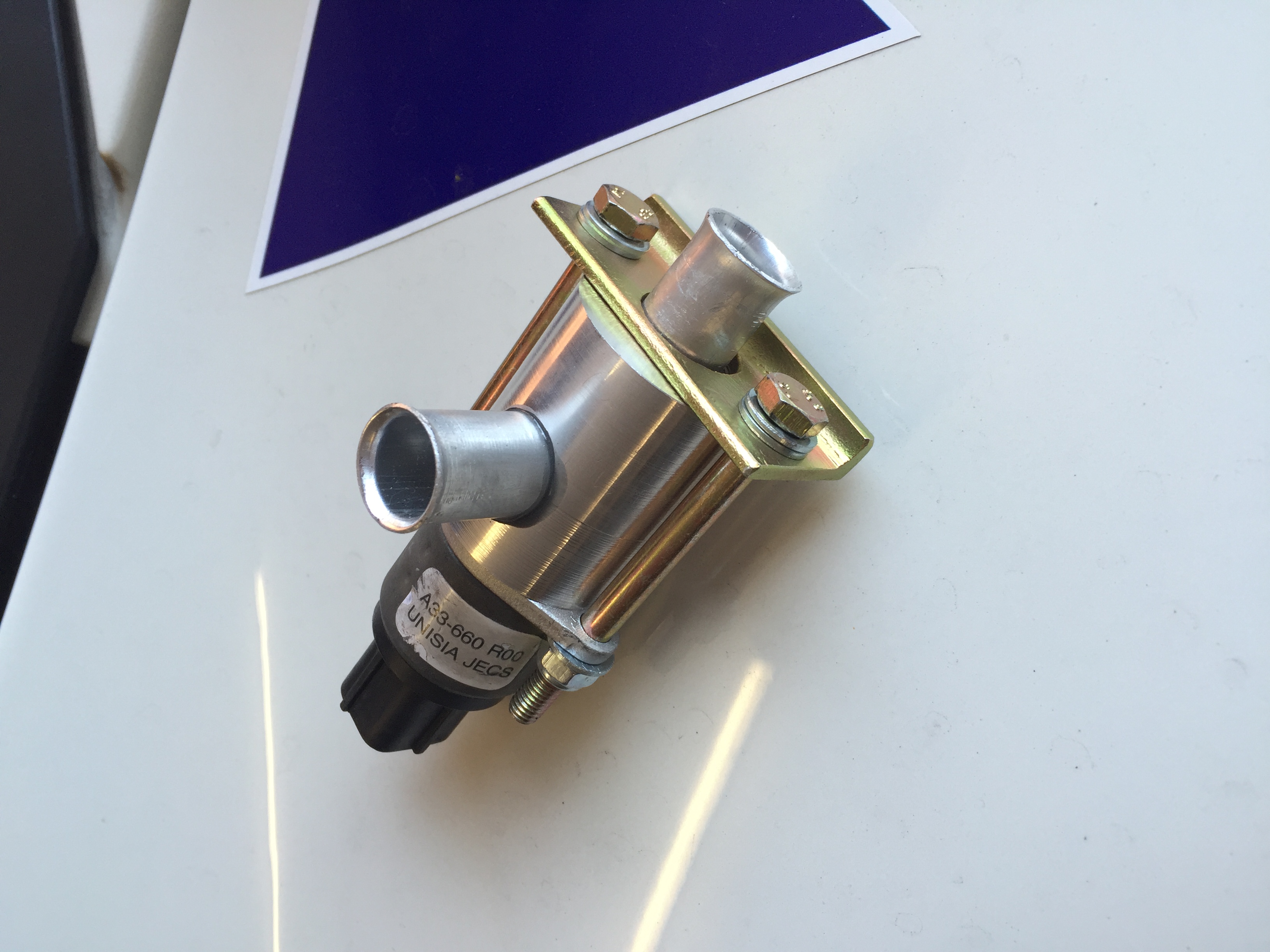

Because I'm switching to electronic throttle on a stand alone system I need to be able for the stock ecu to control idle speed - so took the Subaru iac valve from the cable throttle body & made a new housing for it ....
