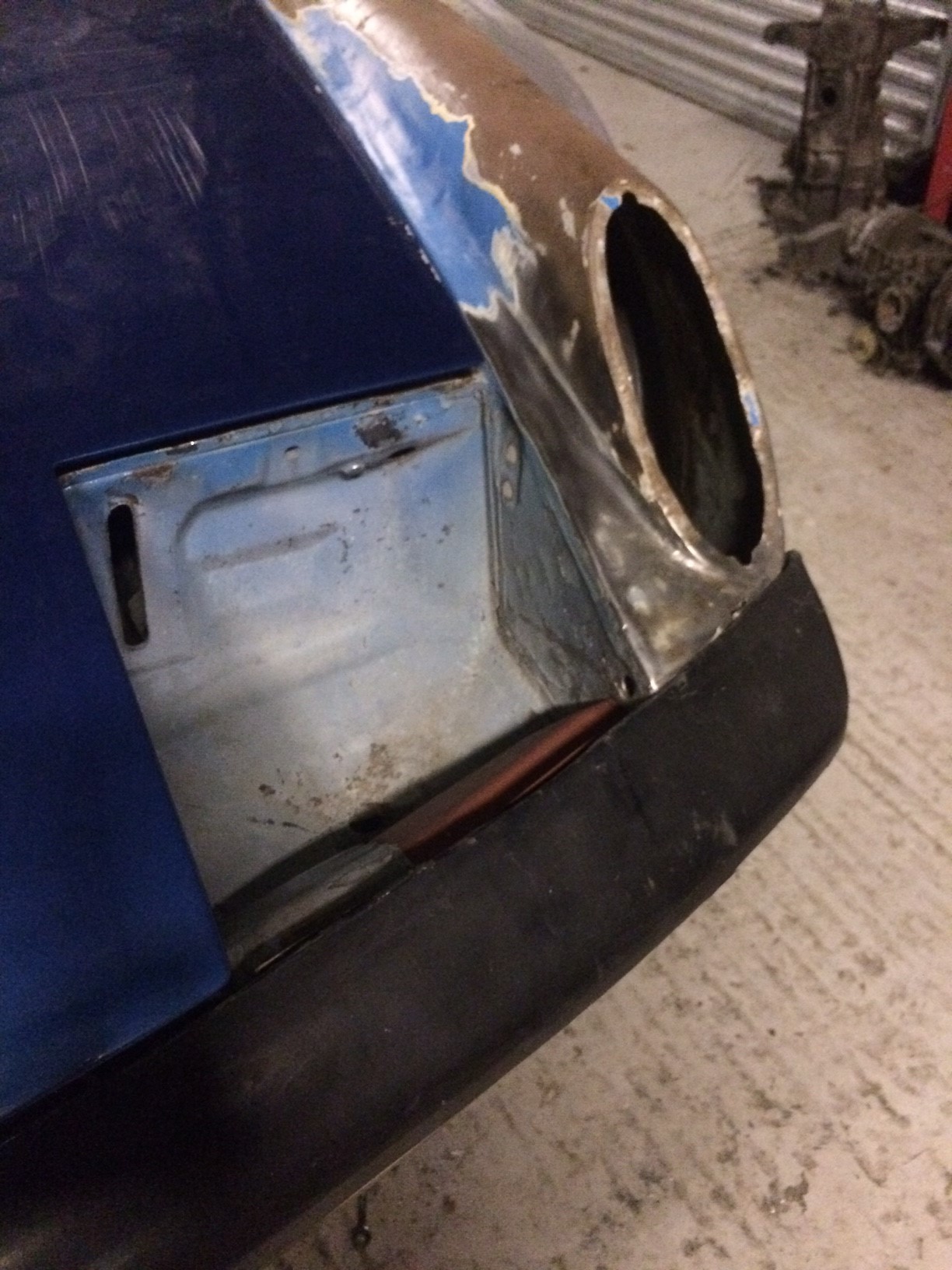

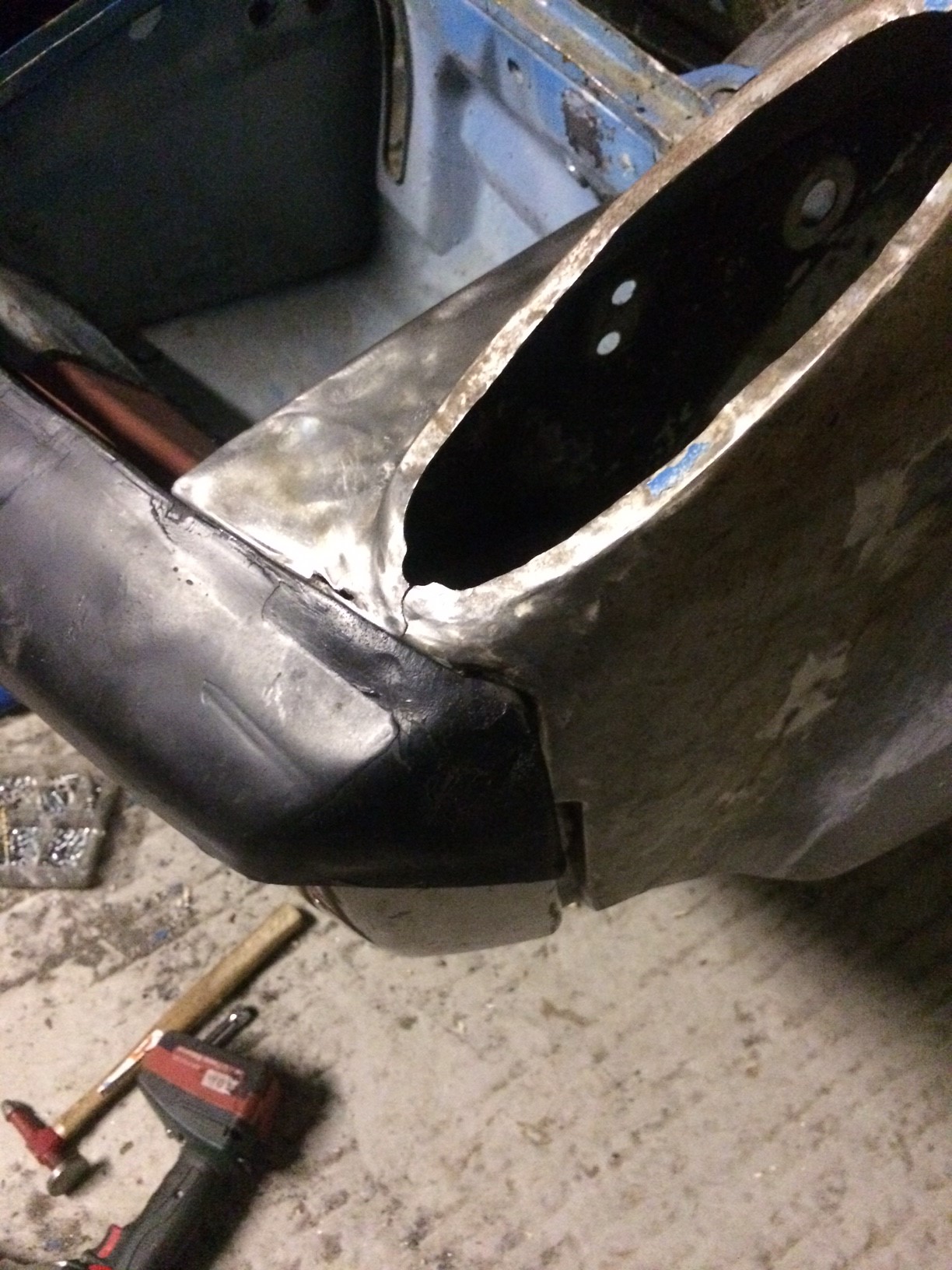

Well the work has progressed ! i spent quite alot of time working on the front of the car as previously told and i was fairly happy with the work so just to make sure everything was good i refitted the hood .............
OMG it wouldn't fit ! the internal rib of the hood was hitting the light box on the previously damaged side ! so after some careful measuring i found the top inner edge of the headlight box was pushed back by 10mm.
i borrowed the porta power from work and pushed it back in to the correct position and then had to start again on the fender ....
