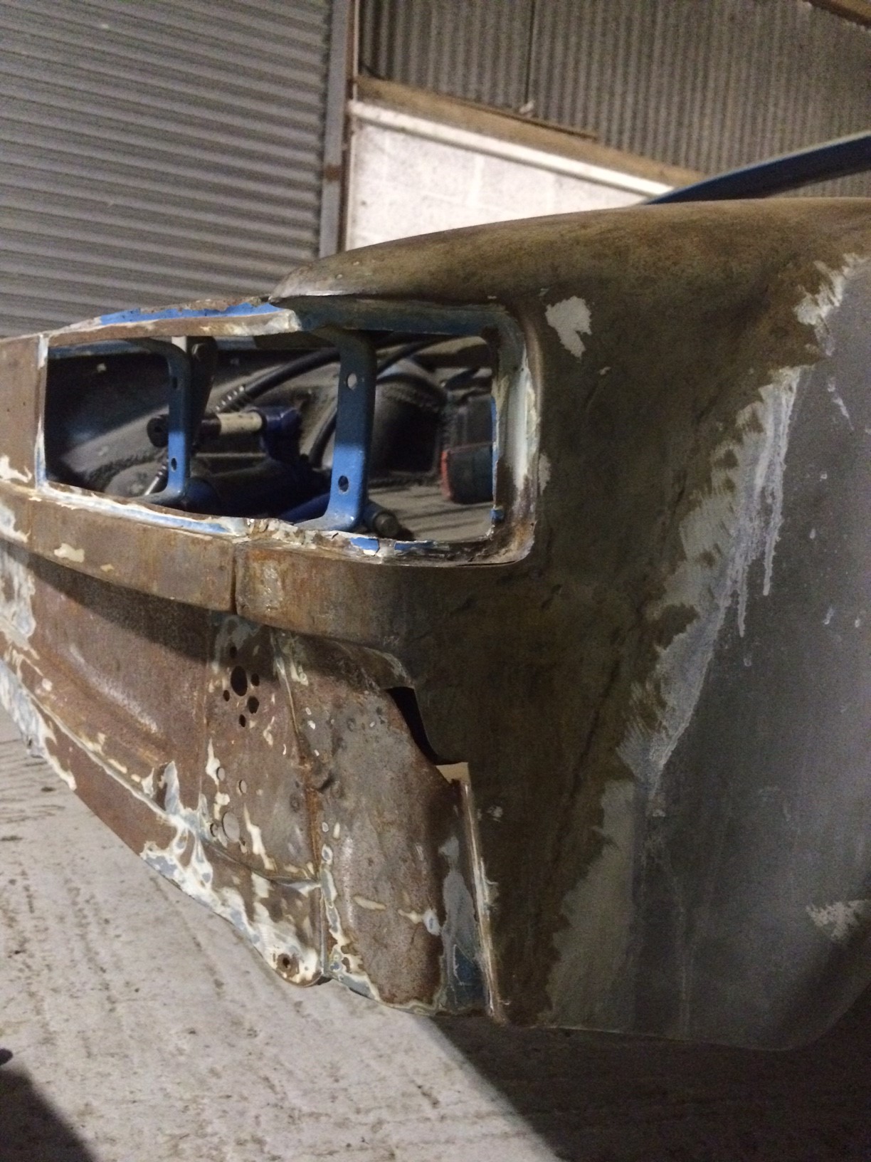

So i'm thinking about the rear corner now...
Does anyone feel like donating a corner say 6" each side and i'll pay the shipping ? i also need the bumper strengthining bracket to !
mine all seems to be about 10mm out, its been hit and partially repaired but its not in the right place by a long shot !
so still a bit to do ....
