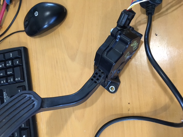

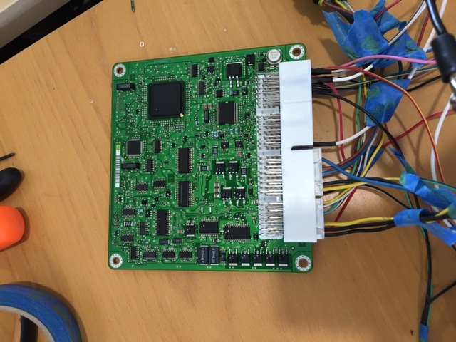

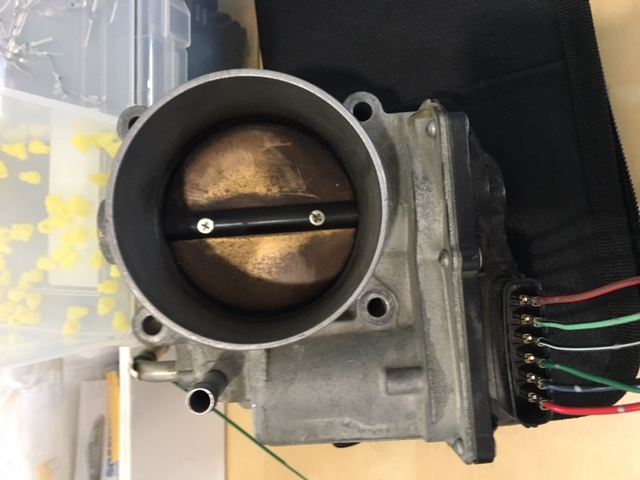

been doing a little work on the throttle body - wanted to move to electronic throttle control - but the Subaru ecu i'm using is cable throttle ...
so, I bought an '07 corolla ECU, a Camry '07 accelerator pedal and a lexus is350 throttle body - all up cost less than $200 shipped to me.
then figured out all the wiring and I have a fully working Drive by wire solution (IMG:style_emoticons/default/smile.gif)
i'll use a TPS out from the throttle body to feed to the Subaru ecu.
this combo will work with any modern Toyota throttle body / pedal combo.
