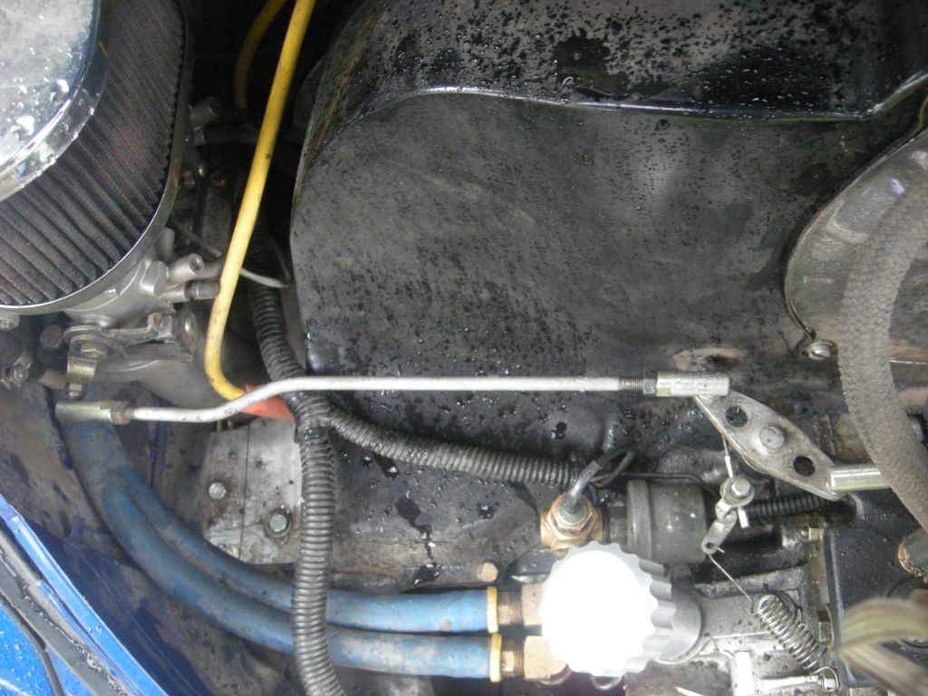

This is the centerpull linkage in the T4 in my bug, see how I made the linkage pull on the arm at exactly 90 degrees to the throttle shaft.
I bent the rod so that it would be 90 degrees and since the joints I use only have CW threads I use the bend to make fine adjustments to the lengths. At idle you take one arm off, get it to perfect sync, then reattach the arm making sure you do not move the sync. I bend the arm slightly till it's the perfect length. Attached image(s)

Mark Henry Looking at your linkage, well to be kind I'll ... Sep 10 2016, 10:06 AM

Garland I've checked mine over it it has a lot of slop... Sep 10 2016, 10:49 AM
Mark Henry
I've checked mine over it it has a lot of slo... Sep 10 2016, 11:30 AM
Mark Henry If you don't have the fab skills for a center ... Sep 10 2016, 11:47 AM
rhodyguy get the new linkage. you can fight it til you... Sep 10 2016, 12:03 PM
Mblizzard I have done the fight. The CFR linkage is the way ... Sep 10 2016, 11:24 PM
Garland Still going to go with the new linkage soon. But f... Sep 11 2016, 01:00 PM![]() ![]() |
