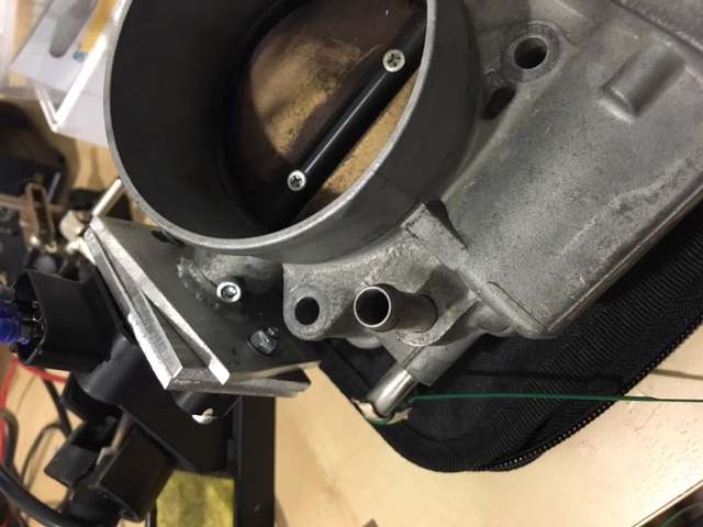

hmm - slight change in plans for the TPS to the Subaru ecu ...
the range outputted from the Toyota throttle body is not matching for the Subaru requirements ...
Subaru needs a range of 0.46v-4.20v
Toyota electronic throttle body outputs 0.79v - 4.00v
so, on the end of the toyo throttle body is a welsh plug - popped this off and have mounted the Subaru tps to the end of the throttle body, its not overly pretty at the moment, just need to fabricate a 'proper' spacer block, but allows me to use the Toyota throttle body, with Subaru tps ...
works perfectly now !
