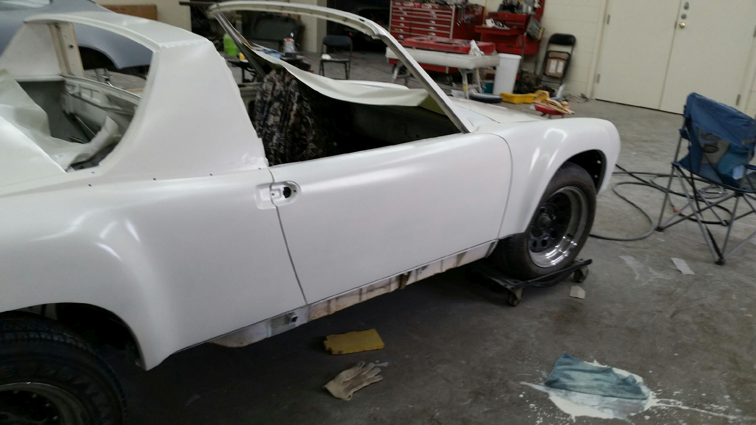

Finally starting my 914-6 GT project after waiting a couple decades. The infection hit me after driving a 911 my employer owned, so I found a '69 912 that I drive for five years until I sold it. Since then, I have been waiting to build a 914-6 GT. John Forbes helped find the starting point for me in October 2015: a white '76 with flares.

The 914 is beginning to look like a GT now. White epoxy was applied last evening. It is looking fine, and is getting a lot closer to going to a paint shop for the green.
