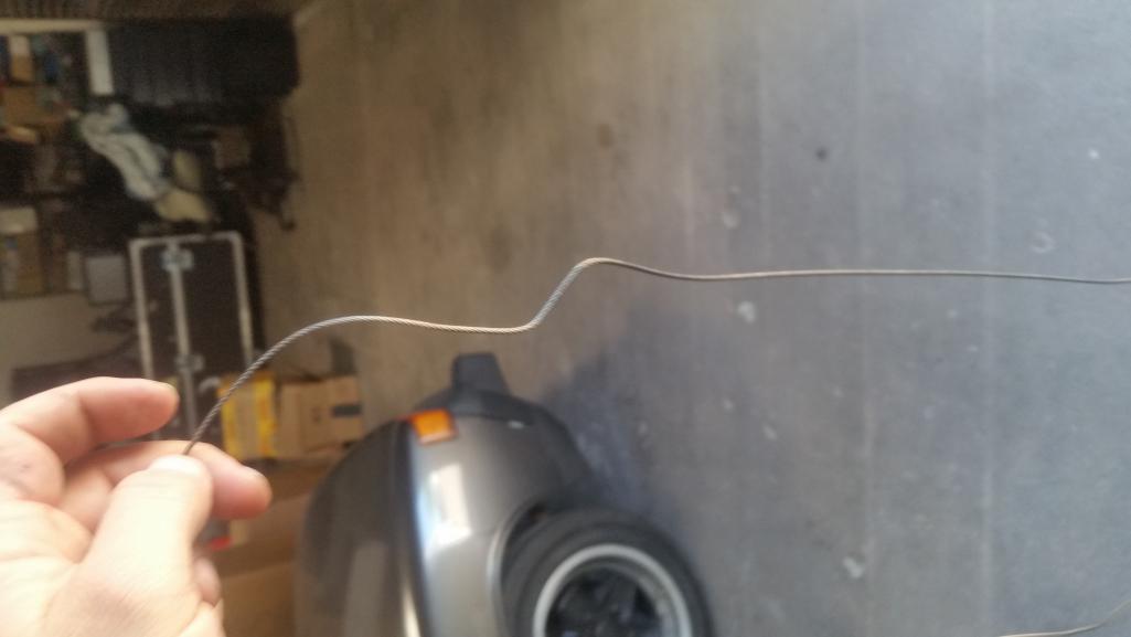

JustinMeier   Wooohoo.. Cable out and it is most definitely bad....   Sep 13 2016, 09:33 PM
ThinAir   Wooohoo.. Cable out and it is most definitely bad...   Sep 13 2016, 09:50 PM
sixnotfour   Its a Slits show ...   Sep 13 2016, 09:54 PM
JustinMeier   Its a Slits show ... You're going to have ...   Sep 13 2016, 10:15 PM
