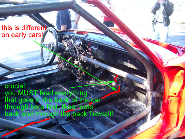

one more:

QUOTE(SirAndy @ Jun 24 2004, 10:48 PM) *
one more:
I'm a bid confused, is the red line on the pic showing the routing of the early or the late car?
Thanks,
Frank

QUOTE(Frank S @ Sep 16 2016, 01:17 AM) *
The car shown is an early car ...

QUOTE(SirAndy @ Sep 16 2016, 07:16 PM) *
Thanks!
