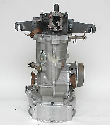

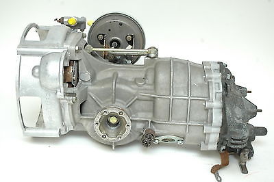

Did a quick google search and found a few things..
Here are a couple of pictures of a 914-6 sportomatic.
Externally, the rear cover looks very similar,
so it may be the same ?????
