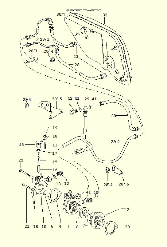

Here is the PET diagram of the oil system.

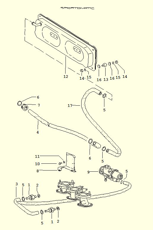

And the Vacuum System.
This is not a trivial task on a six. You have to find all the parts before you can start.
IF it is a four, I wouldn't even try. I would look for the Audi 5000 trans. It would work better than the sportomatic, and easier to install.
