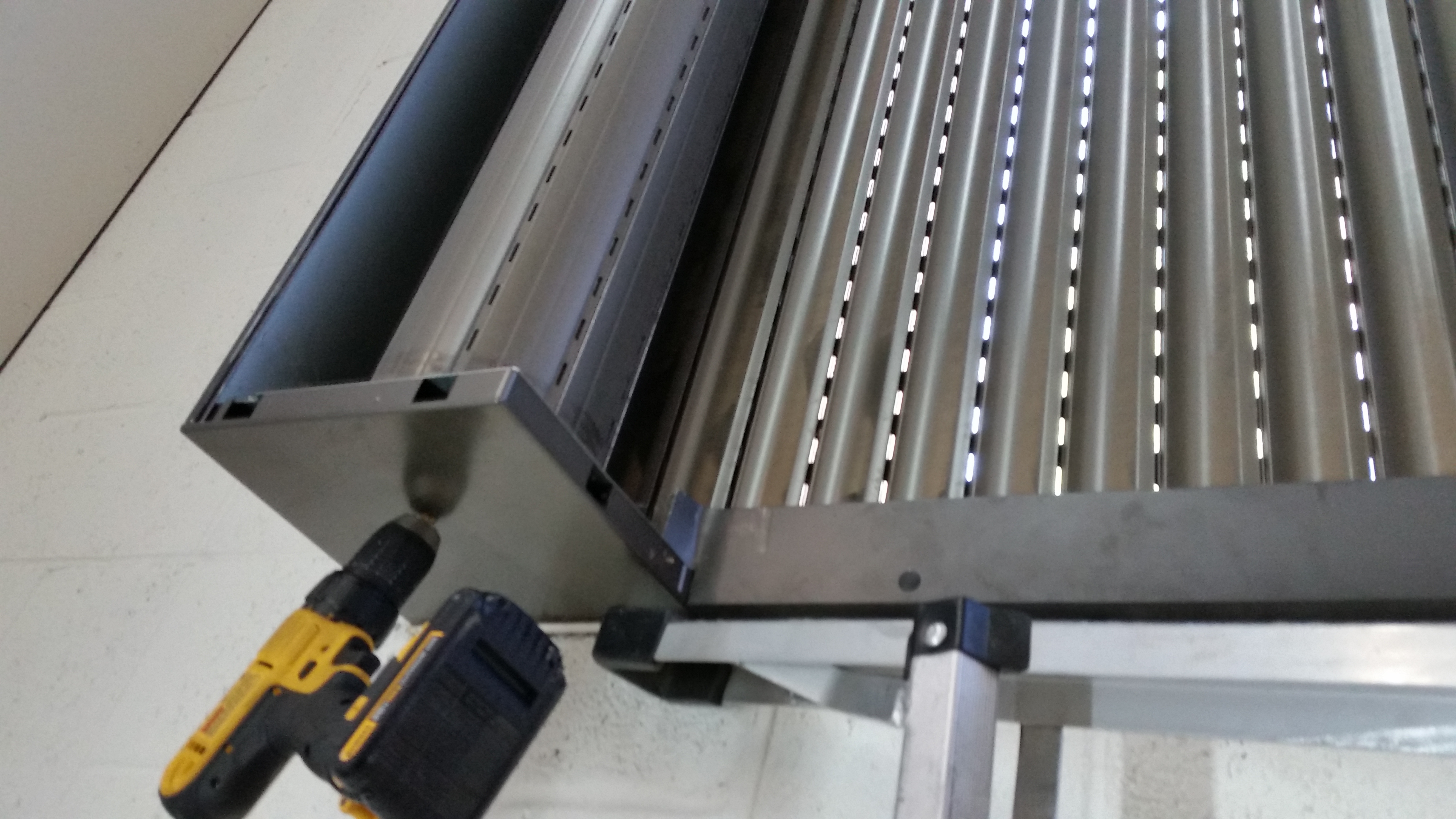

Well sorta.. this side of the door broke and fell down. Drilled a hole and used the bit for a roller. Worked enough to get it out. Cable is a bit tight but I'll have 2 brand new ones Tues.
