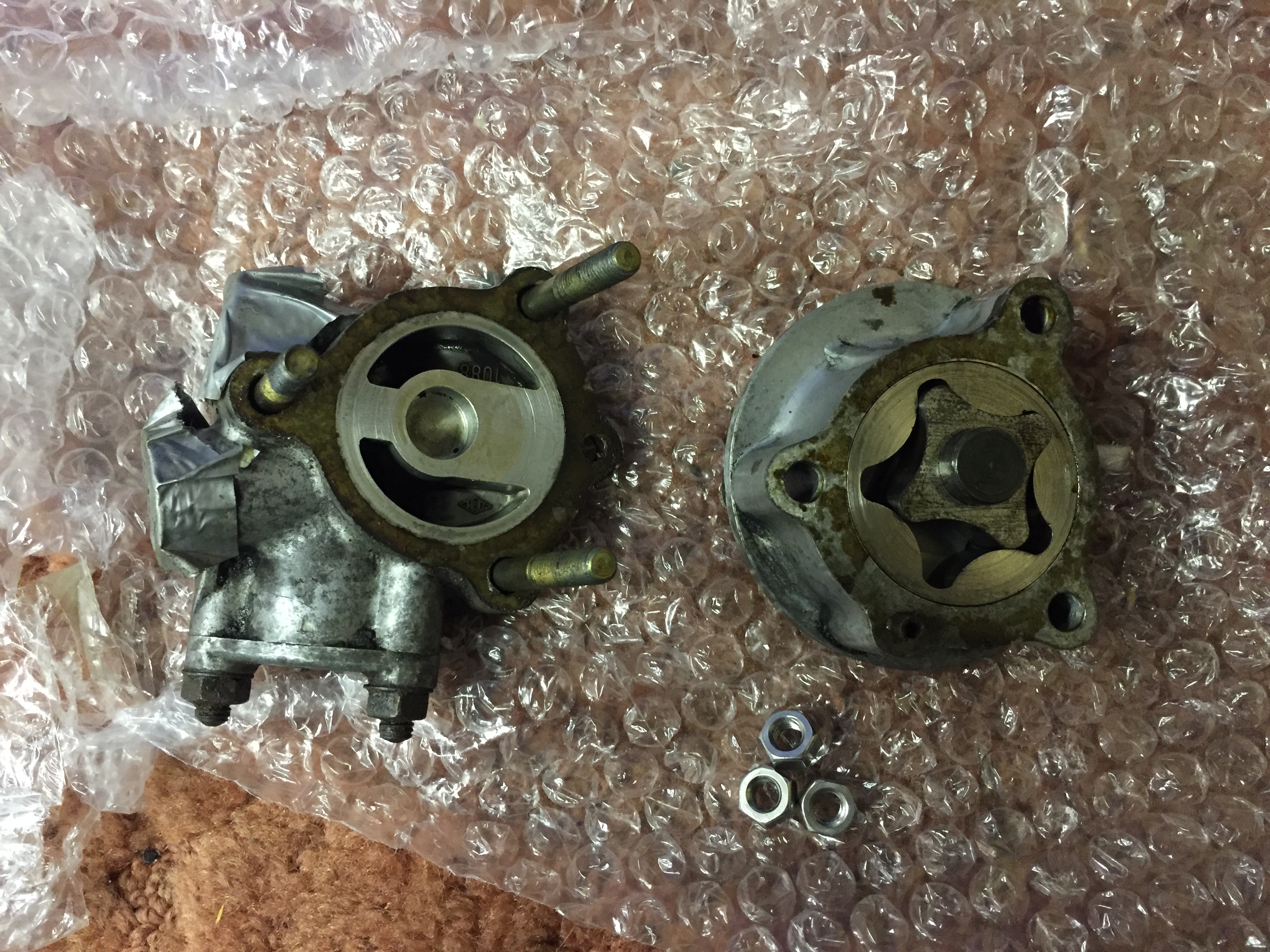

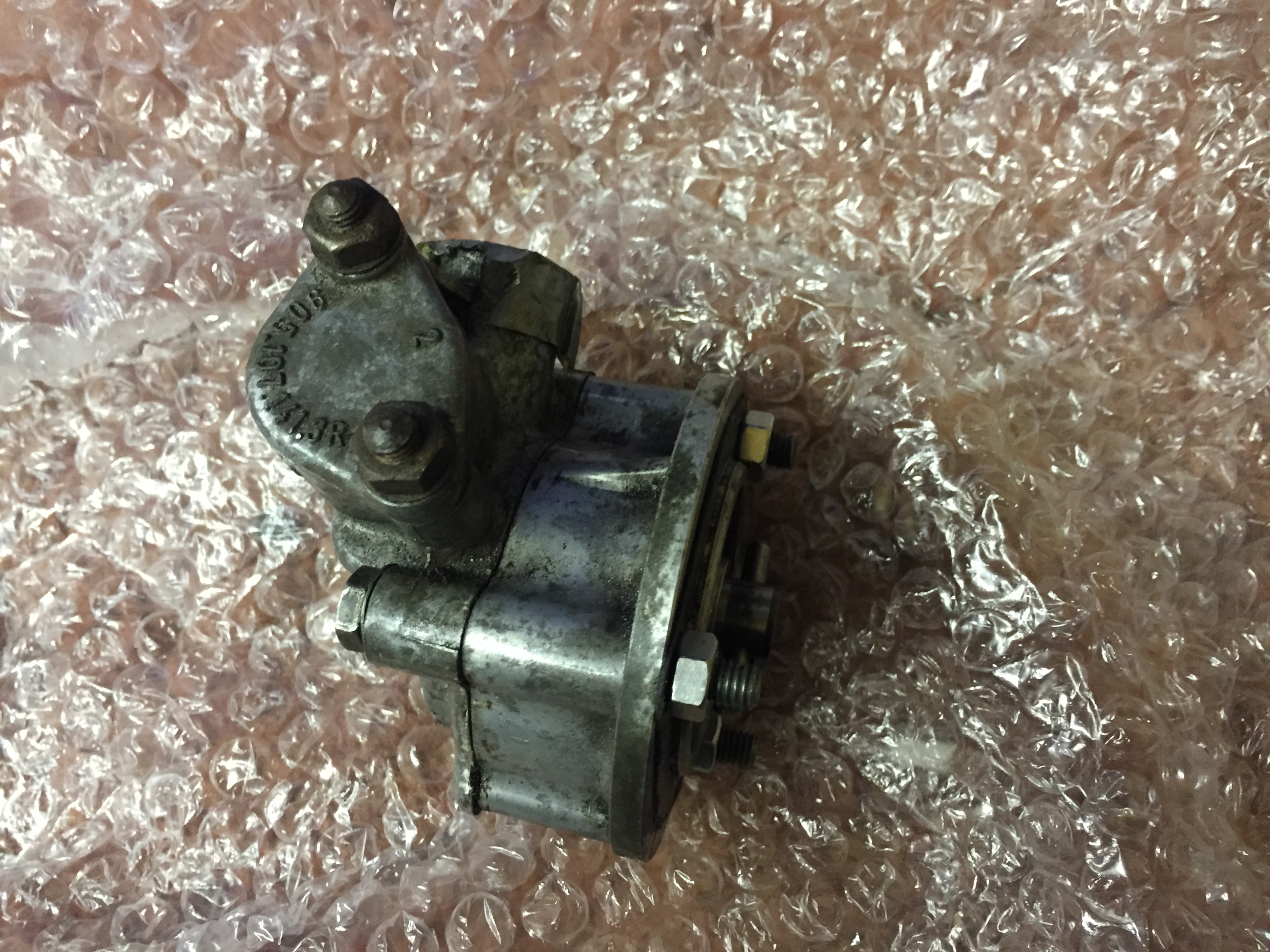

I have an oil pump, fits to the rear of the six engine and powered off the cam (same side that powers the MFI pump pulley. The sporto oil pump was also used on GTs for gearbox cooling

SixerJ   I have an oil pump, fits to the rear of the six en...   Sep 17 2016, 03:29 PM
