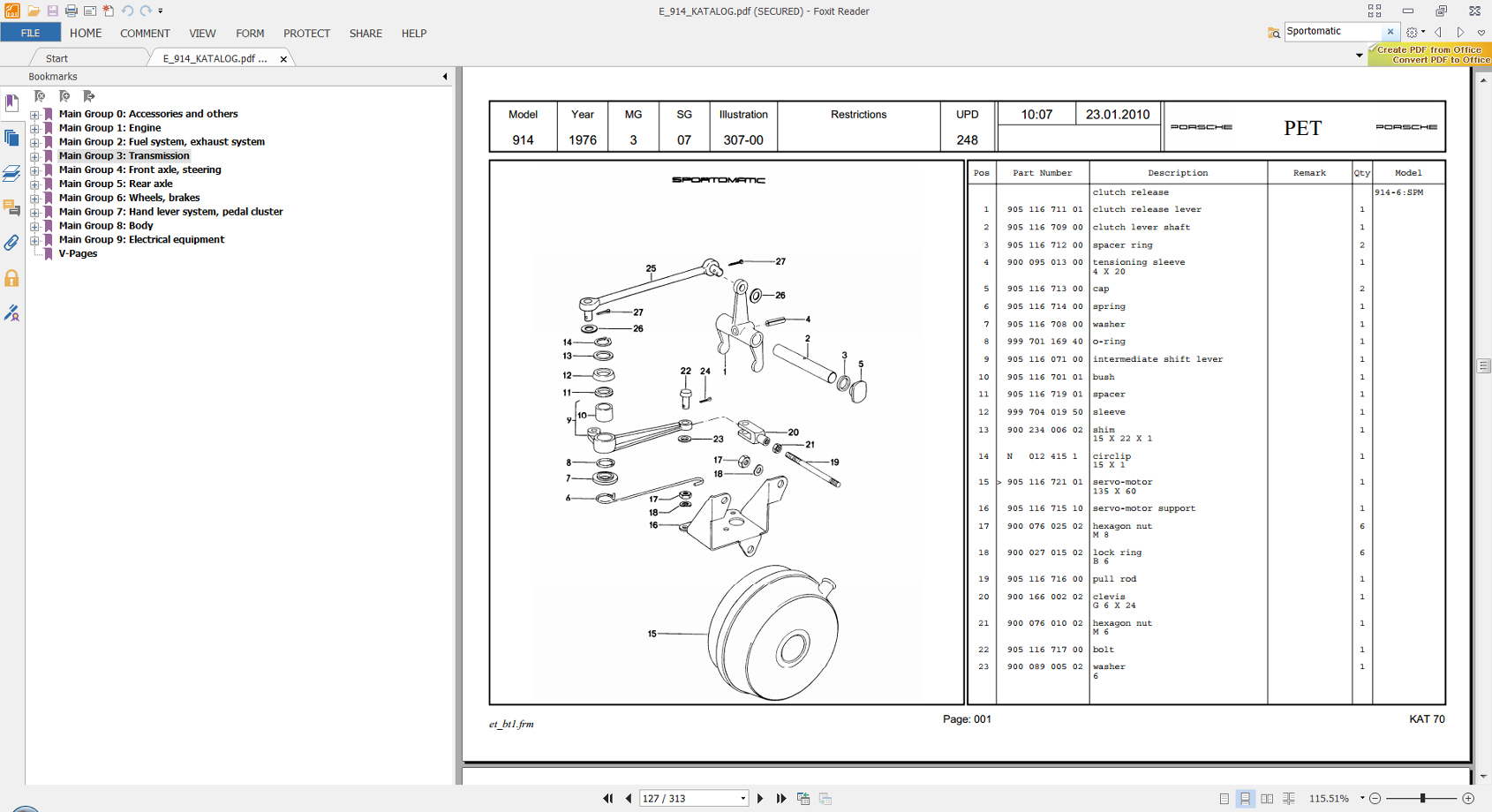

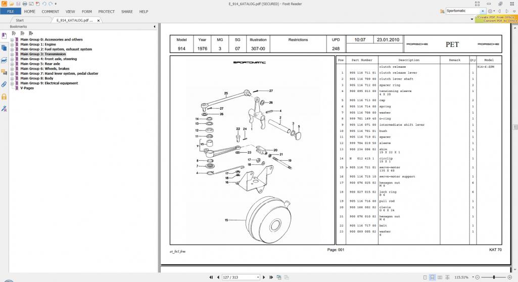

QUOTE(andrewvolsen @ Sep 20 2016, 11:43 AM) *
The parts catalogue available as a PDF here includes diagrams and part numbers for all of the 914-6 sporto stuff:
http://www.porsche.com/all/media/pdf/origi...lkXobggzeflWo6g
Dokument nicht gefunden.Link nfg.
http://www.porsche.com/all/media/pdf/origi...914_KATALOG.pdf
Pg 127/314-Sportomatic.
Every owner and interested party should have this katalog,all the parts.
