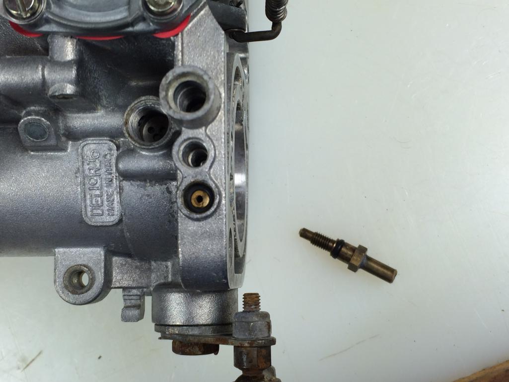

I have reached out to Blackline Racing to see if the washers for the mixture needles are available from them. Another question, in the pic below:
What appears to be a vacuum port is broken off in the body of the carb (non-broken piece on bench below). I'm showing my ignorance with these carbs, but how necessary is that fitting? It appears to simply stub out in the body of the carb, I won't be taking any vacuum signals from these carbs so I would plug it anyway? This is part #49 on the DRLA exploded diagram in the Dellorto Superperformance book, described as the pressure fitting (or something similarly mis-translated from Italian).
I'd like to remove the broken bit and make it right, but I know it'll be tricky getting it out. Will need thread/screw reverser, patience and luck...

rhodyguy   If you can, plug it in a reversible fashion. Exami...   Sep 20 2016, 02:00 PM
sdoolin   Thanks rhodyguy, I understand "plug it in a r...   Sep 20 2016, 04:36 PM
rhodyguy   Sorry. Idle Air Mixture Screw. They only require a...   Sep 20 2016, 05:58 PM
