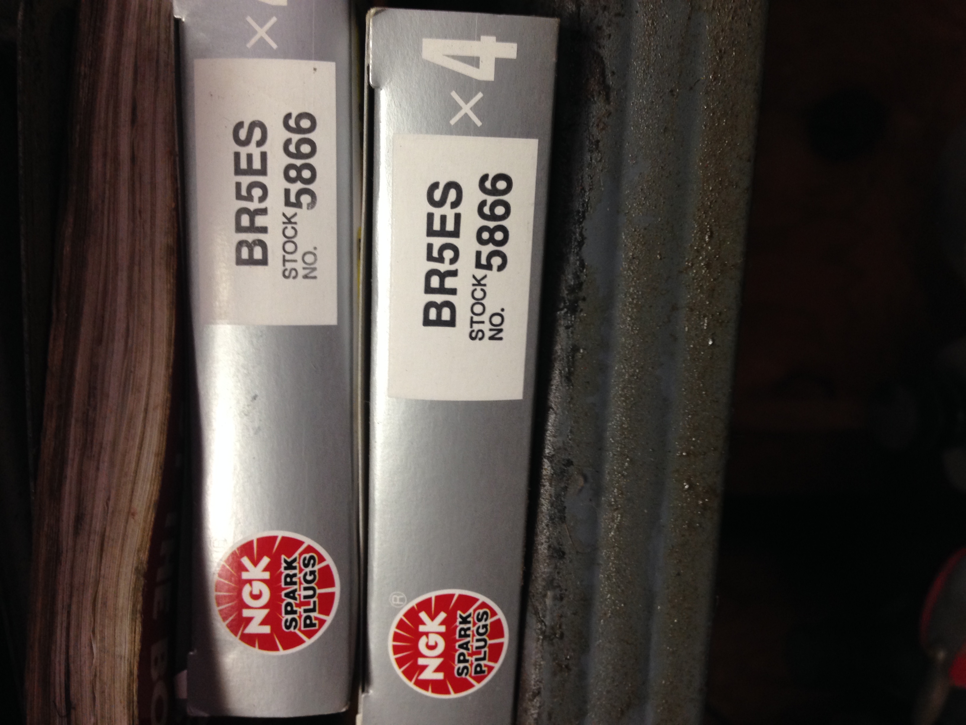

Also, I run these plugs in my 914. They run a tad hotter.
