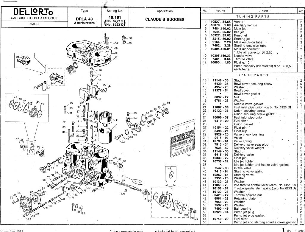

anderssj
post Sep 22 2016, 10:48 AM
Dog is my copilot...
Posts: 1,750
Joined: 28-January 03
From: VA
Member No.: 207
Hope these help!

anderssj   Hope these help! Page 1:   Sep 22 2016, 10:48 AM
anderssj   Page 2:   Sep 22 2016, 10:49 AM
sdoolin   Very helpful, thanks for uploading. Much easier on...   Sep 22 2016, 12:06 PM
anderssj   Very helpful, thanks for uploading. Much easier o...   Sep 22 2016, 01:18 PM
