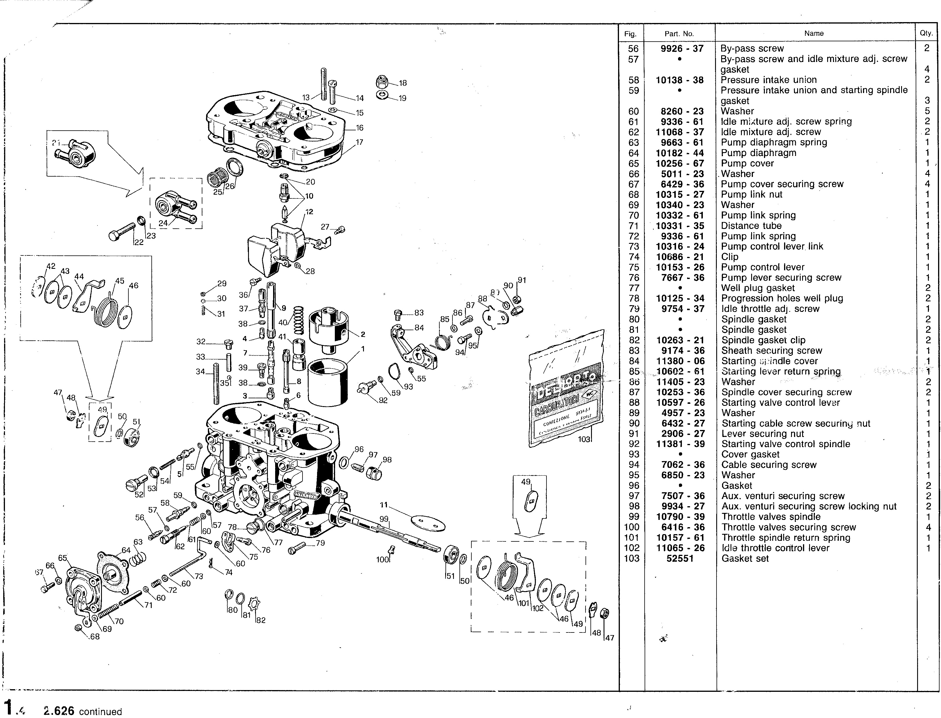

sdoolin   Another question - I swore that the Dellorto Super...   Sep 21 2016, 11:45 AM
rhodyguy   3 thousands. P.3 if you have the dellorto superfor...   Sep 21 2016, 12:44 PM
sdoolin   3 thousands. P.3 if you have the dellorto superfo...   Sep 22 2016, 06:03 AM
anderssj   Hope these help! Page 1:   Sep 22 2016, 10:48 AM
anderssj   Page 2:   Sep 22 2016, 10:49 AM
sdoolin   Very helpful, thanks for uploading. Much easier on...   Sep 22 2016, 12:06 PM
anderssj   Very helpful, thanks for uploading. Much easier o...   Sep 22 2016, 01:18 PM
anderssj   Give these guys a try--they were a big help when d...   Sep 22 2016, 01:01 PM
