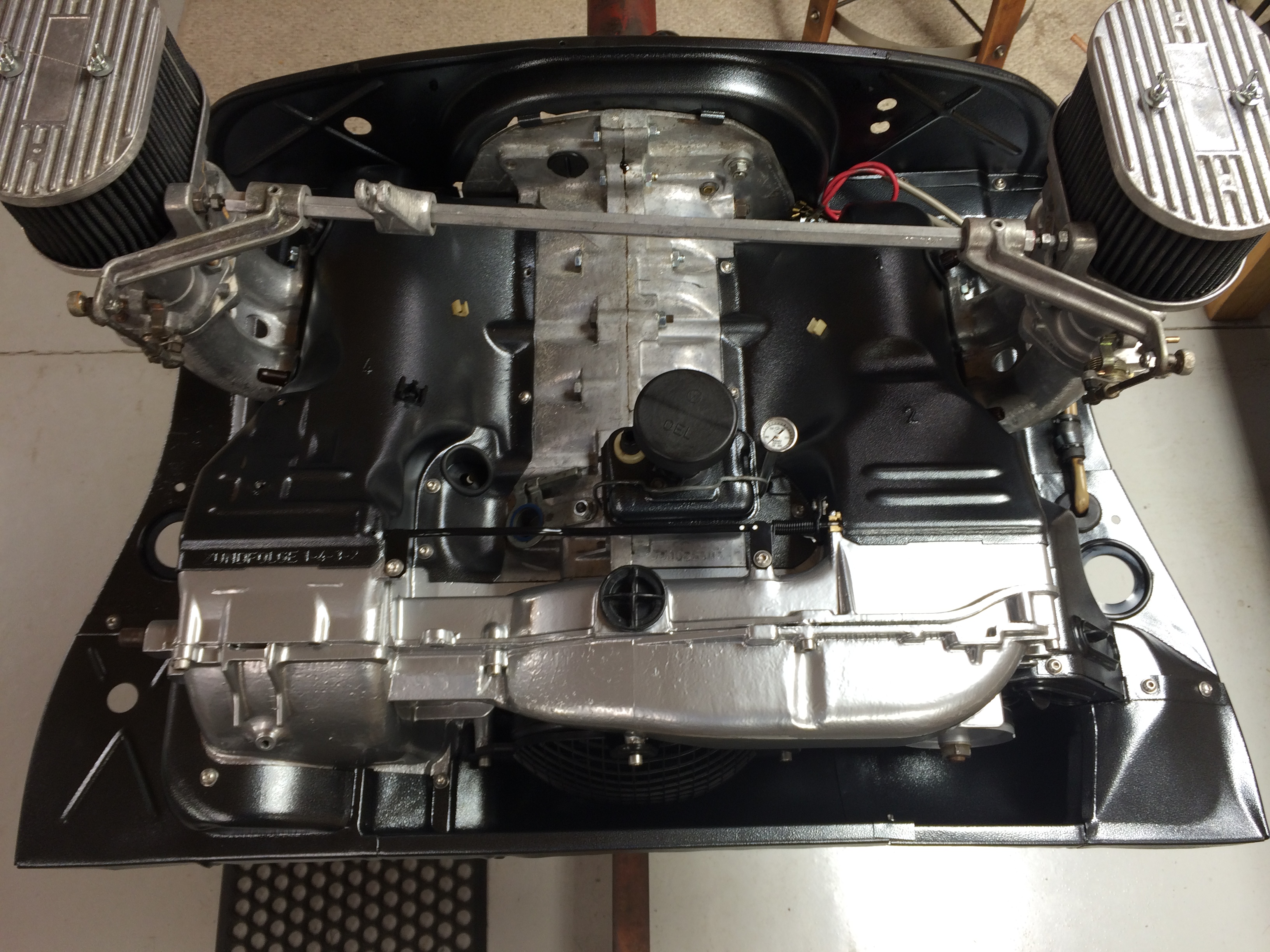

Here's my set-up so far. I may move the linkage to the rear to get more room for a throttle cable bracket.
