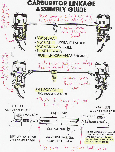

Here's my set-up so far. I may move the linkage to the rear to get more room for a throttle cable bracket.
Another drawing/install guide from CB Performance (with my notes from about 30 years ago (IMG:style_emoticons/default/blink.gif) )
On mine, the throttle arms point down and out-board, pull arm is below the cross-bar per the drawing. I think I found that easier for adjusting the linkages when balancing carbs, etc.
