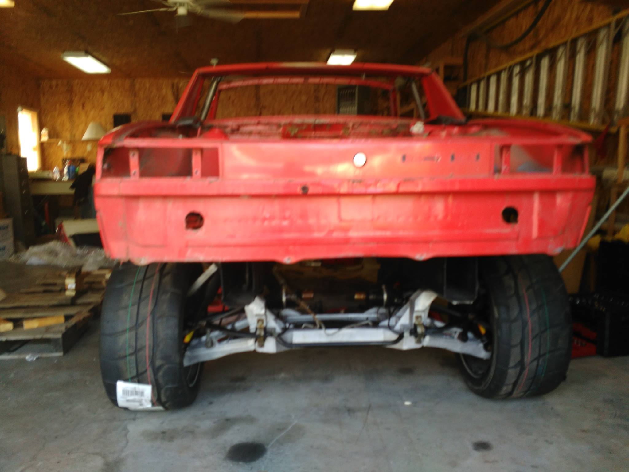

Here suspension is put this under the car to get an idea how wide it will be. I have some rust issues to take care of prior to getting suspension fit. Also want to get interior cage built and build off that. Will most likely tie in corvette frame rails as engine and trans fit inside. Need to put a bar in rear off car that sticks out about 2 inches and rear rails should weld up. Leaf springs might be an issue and will convert to coil over if that Is the case.

Stacks914   Here suspension is put this under the car to get a...   Sep 28 2016, 12:58 AM
Stacks914   I think I might be able to get away with 3 inch fl...   Sep 28 2016, 01:10 AM
