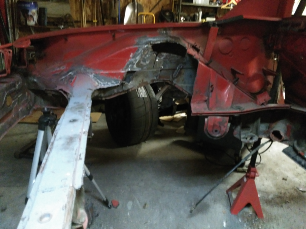

Here I got a little over zealous with the sawzall. Though the inner fender walls are too far apart for tire/a-arms so will fab own wells after rear frame gets installed

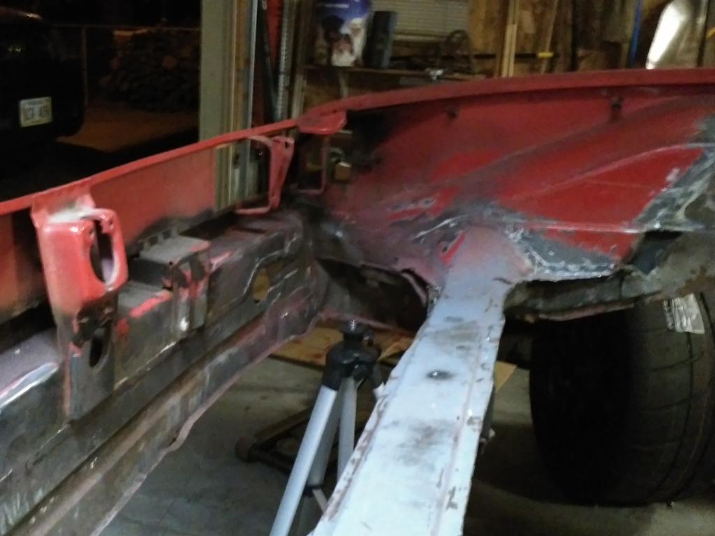

Stacks914   Here I got a little over zealous with the sawzall....   Sep 28 2016, 08:53 PM

Stacks914   Here is am getting an ides of the well that I need...   Sep 30 2016, 11:58 PM
Stacks914   In the land of coulda, shoulda, woulda I would hav...   Oct 1 2016, 12:34 AM
Stacks914   Then to remeasure and wonder what the fuck you whe...   Oct 1 2016, 02:04 PM
