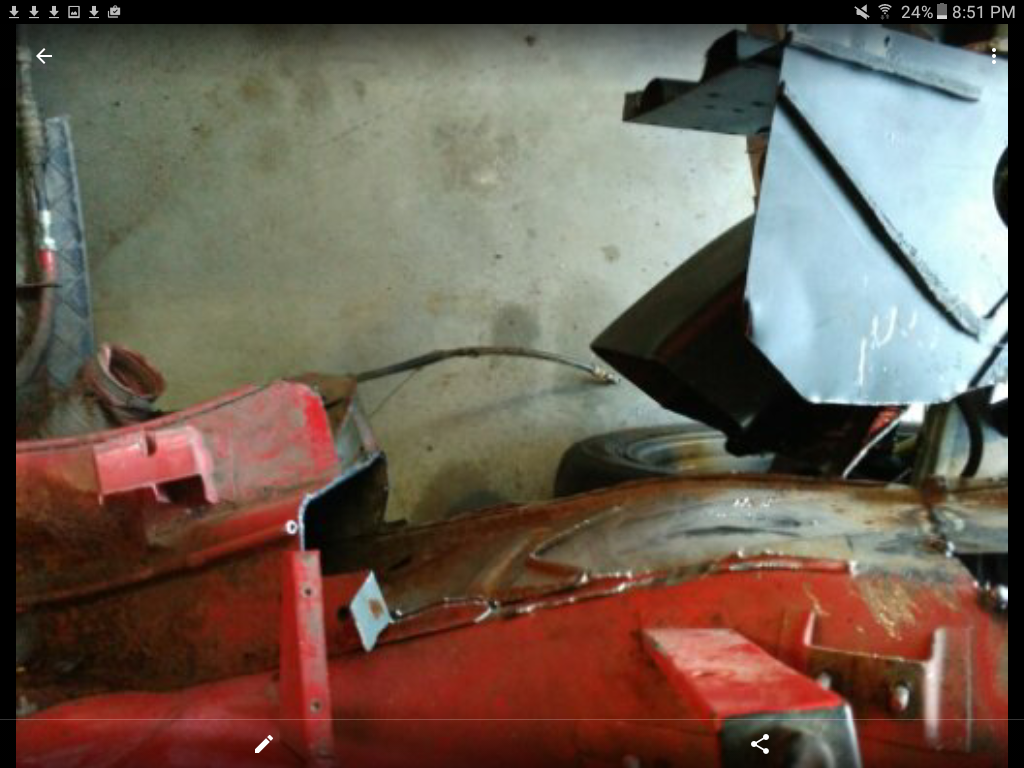

Ok guys I am posting picks of building my car. I have about three days maybe 12 hours total on this Build of actual of the car. I am in a build off.... So here are pics of the car and what I have been doing. I am really just currently deconstructing. The build will have a corvette c6 front and C5 rear suspension and a tube chassis, and c5 z06 rims that are 17/18. The powertrain I have is a 5.3 out of an 04 silverado. the trans is a boxster S unit. I also have a 70mm turbo for the engine. I have purchased but am still waiting on the adapter. Will probably be extending the rear of the car at least 5-8 inches as I would like to use the stock accesorys. or I would like to keep the power streering pump at least and the alternator. I am a bigger guy and really cannot sacrifice any room inside. Plus I would like a nice stereo in there(and a hot woman). And that is about it. I am just a one man operation building this car out of his garage. I do not own a shop. I will be doing all of the work myself or as much as possible. I realize I am in a build off but really this is cheap entertainment for me. So please lets keep it entertaining. Currently in Omaha NE and no one knows what this car is. but they do think its cute and want one...lol. I have not seen one of these on the road in years. I have 2. This red one I bought with the intentions of flipping and making some quick money. After about 6 weeks of trying to sort out the engine my patience and money I had allocated for this car was done. So it became the focus of the build only becuase it was titled in Ne and would not have go through inspection. I realize I am in way over my head here (IMG:style_emoticons/default/wink.gif) thats where i am comfortable. The welding on the car will be conducted by a local professional that works on nuclear reactors until I am comfortable I can do it but its really not that hard and I am getting better. While I am currently on 31 total hours of work time. I have about 6 months of research into the car putting together a broad stroke design and I do not have every aspect of this car figured out in my head. I deal with the details as they arise! this might seam maddning to some of you but please bare with me!

This is when you just stare for 2 hours wondering exactly how this is going to happen.

Stacks914   Anyways this project is back on....currently. I r...   Sep 28 2016, 12:49 AM
Stacks914   You can see in the last picture I have bent the re...   Sep 28 2016, 12:54 AM
Stacks914   Here suspension is put this under the car to get a...   Sep 28 2016, 12:58 AM
Stacks914   I think I might be able to get away with 3 inch fl...   Sep 28 2016, 01:10 AM

Stacks914   Here I got a little over zealous with the sawzall....   Sep 28 2016, 08:53 PM
Stacks914   With a sawzal you can do anything   Sep 29 2016, 07:54 PM
Stacks914   Just allow me to stuff this in there....   Sep 29 2016, 07:56 PM
Stacks914   This is when you just stare for 2 hours wondering ...   Sep 29 2016, 07:57 PM
Stacks914   It's getting lower   Sep 29 2016, 07:59 PM
Stacks914   Here is am getting an ides of the well that I need...   Sep 30 2016, 11:58 PM
