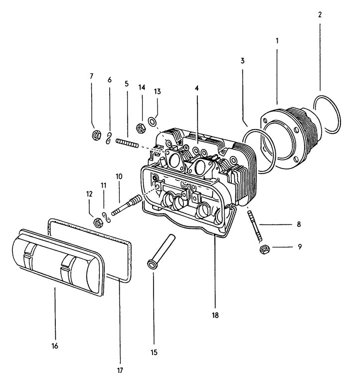

As I begin to source the components, I have a question about the Sealing / Spacer Ring between Cylinder and Head. Item No. 3 in the following illustration: Standard sizes are 93x104 for 1.8 and 94x105 for 2.0. When 96mm Piston/Cylinders are used, Is the size of these rings dictated by the Piston/Cylinder diameter (in this case 96mm) or the type of Head being used ( 1.8 in this case) ? Also I gather the thickness on the spacer ring plays a part in Compression Ratio? Any rough idea what thickness is required for 8.1:1? |

As I begin to source the components, I have a question about the Sealing / Spacer Ring between Cylinder and Head. .... When 96mm Piston/Cylinders are used, Is the size of these rings dictated by the Piston/Cylinder diameter (in this case 96mm) or the type of Head being used ( 1.8 in this case) ? The area in the head where the cylinder sits (the "register") should be the same for 1.8 and 2.0 heads, 105mm. So you could use either a 2.0 or a 1.8 head gasket. Or none at all; there is a strong contingent who contend that head gaskets should not be used, and that the cylinders should be lapped to the head registers instead. QUOTE Also I gather the thickness on the spacer ring plays a part in Compression Ratio? Any rough idea what thickness is required for 8.1:1? The spacer definitely plays a part in the compression ratio. But the heads, the top of the pistons, the deck height of the pistons (distance of the top below the top of the cylinder), and so on also have a pretty big effect. You will have to measure to figure out what you have, and do the math. --DD |
