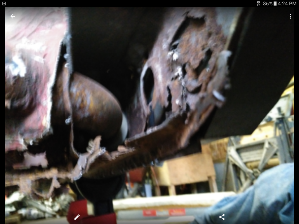

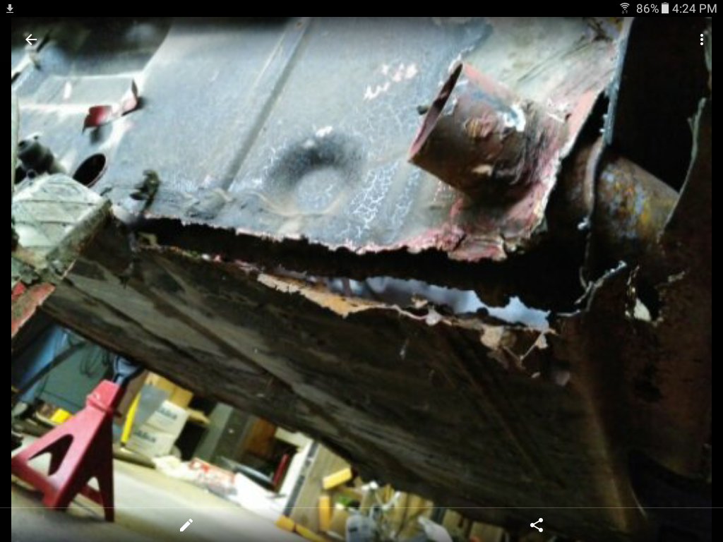

Though this car has the Brad Meyer kit it's well....this is what I am dealing with today
