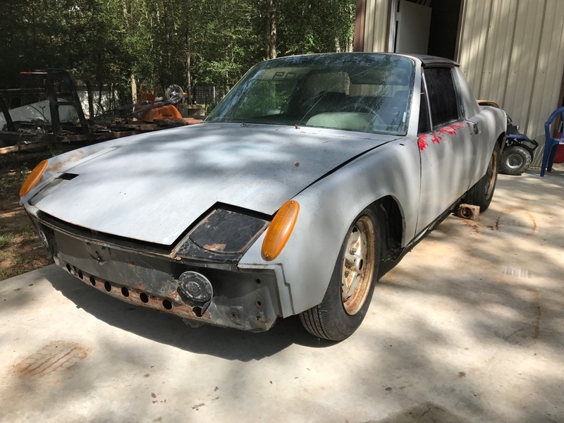

Hi 914World,
New(ish) member with new project - a 1975 2.0L. It's certainly a project, but I think it's a great starting place. The seller is extremely knowledgeable about the car and helpful with local contacts who are in the 914 scene. It's been on the local CL for a while for more than I wanted to pay, but was recently able to strike a deal. Here are some specs about the project:
  • "Rust Free" car with the only rust being on the surface of cleaned metal
  • Hell-hole looks very clean
  • All original glass, bumpers, interior, suspension, rims, etc. are included
  • 901 "side shift" transmission has been taken apart, inspected, and rebuilt
  • Lowered hard mounts for drivetrain
  • There are some spares included as well (doors, top, misc. / etc.)
The engine is the gem of this purchase in my opinion. Here are the details:
2055cc "build" project in pieces currently (with matching numbers)
  • All balanced / clearance as necessary by H&H in Dallas
  • 96mm Pistons / Cylinders
  • 9.0:1 compression ratio
  • 3-angle valve job on 2.0 Heads
  • Iskenderian Cams #485128 Grind #VP-228
  • Claude's Buggies' Lightened Lifters
  • Lightened Flywheel
  • Custom High RPM Cooling Fan
  • Rotating assembly has been coated with polymer or ceramic coatings by Polymer Dynamics in Houston
I've put down a deposit to hold and will be picking up on Monday. I'll post pictures as soon as I can. Plans are for a mostly stock rebuild with an attempt to retain as much value as possible.
Looking forward to this one!

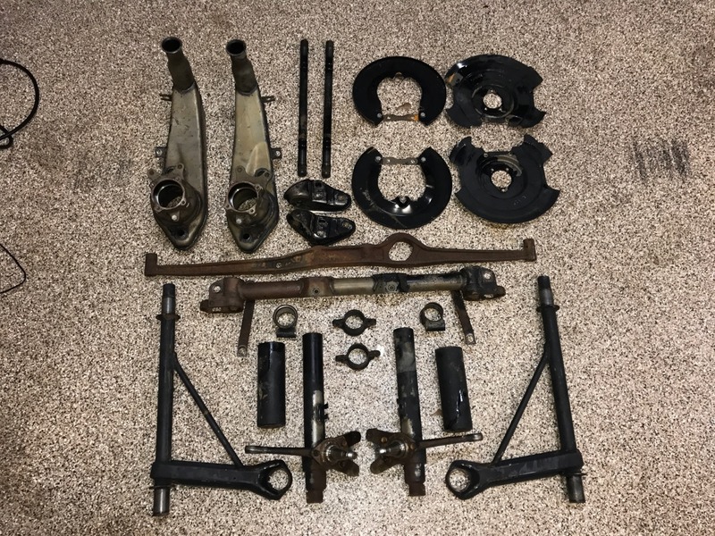

Got the parts car moved out of my storage unit and my uncle is letting me park it in a square of his shop driveway. I spent a good 3 hours pulling parts with a buddy and my Dad last weekend.
(IMG:http://www.914world.com/bbs2/uploads_offsite/i120.photobucket.com-19557-1475640348.1.jpg)
Also got the trailing arms out and suspension completely disassembled:

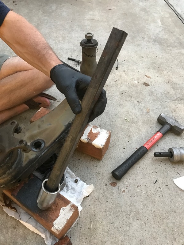

Our homemade bearing driver tool:
(IMG:http://www.914world.com/bbs2/uploads_offsite/i120.photobucket.com-19557-1475640349.4.jpg)

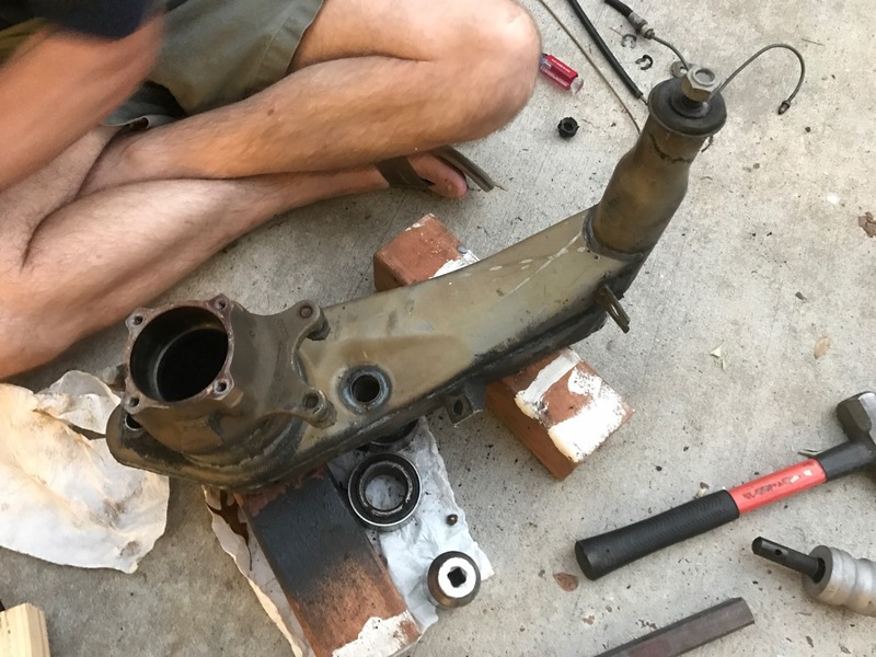

Ended up using a 1.5" piece of metal pipe to get these out of the arms:
(IMG:http://www.914world.com/bbs2/uploads_offsite/i120.photobucket.com-19557-1475640349.5.jpg)

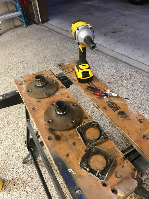

Ready to head to the powdercoater tomorrow:
(IMG:http://www.914world.com/bbs2/uploads_offsite/i120.photobucket.com-19557-1475640350.6.jpg)
