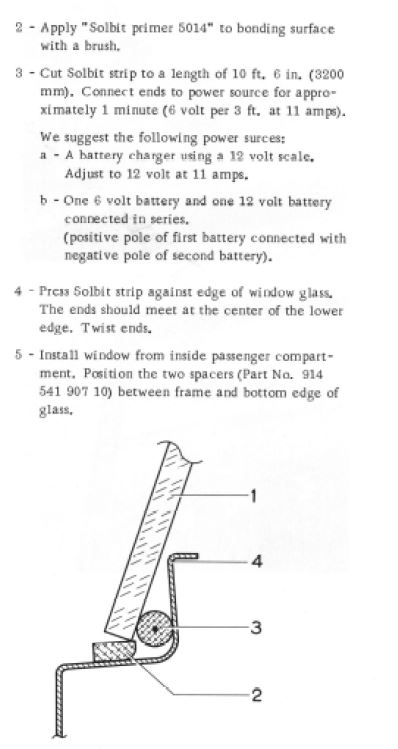

The factory butyl had a wire in it. It was Solbit 8mm and made by Bostik - not sure if it is available anywhere anymore.
This is from the Workshop Manual:
87m491

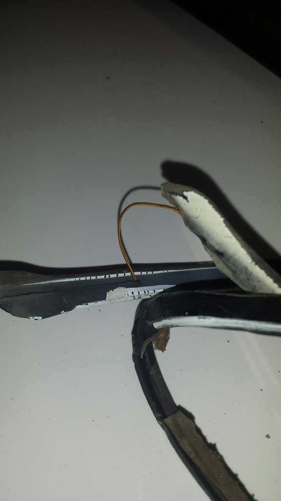

Just did this last week. I found that factory drawing to be off a bit. I used 3/8s (9.5mm) from NAPA and wished I used the 5/16s (8mm) my factory blocks were still in place and with the 3/8s butyl, I could barely get my glass to sit over/on them as the butyl was so thick. I'd guess at ambient of 90 or so there is more give. It was 70 maybe, and even with a heat gun to warm the glass and butyl the glass sat further out than I was happy with.
The original tape I removed was compressed to between 2 and 3mm. No way for me to get that thin with 3/8s
(IMG:http://www.914world.com/bbs2/uploads_offsite/i723.photobucket.com-14731-1475951700.1.jpg)
