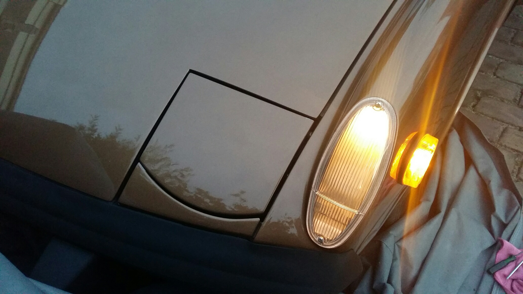

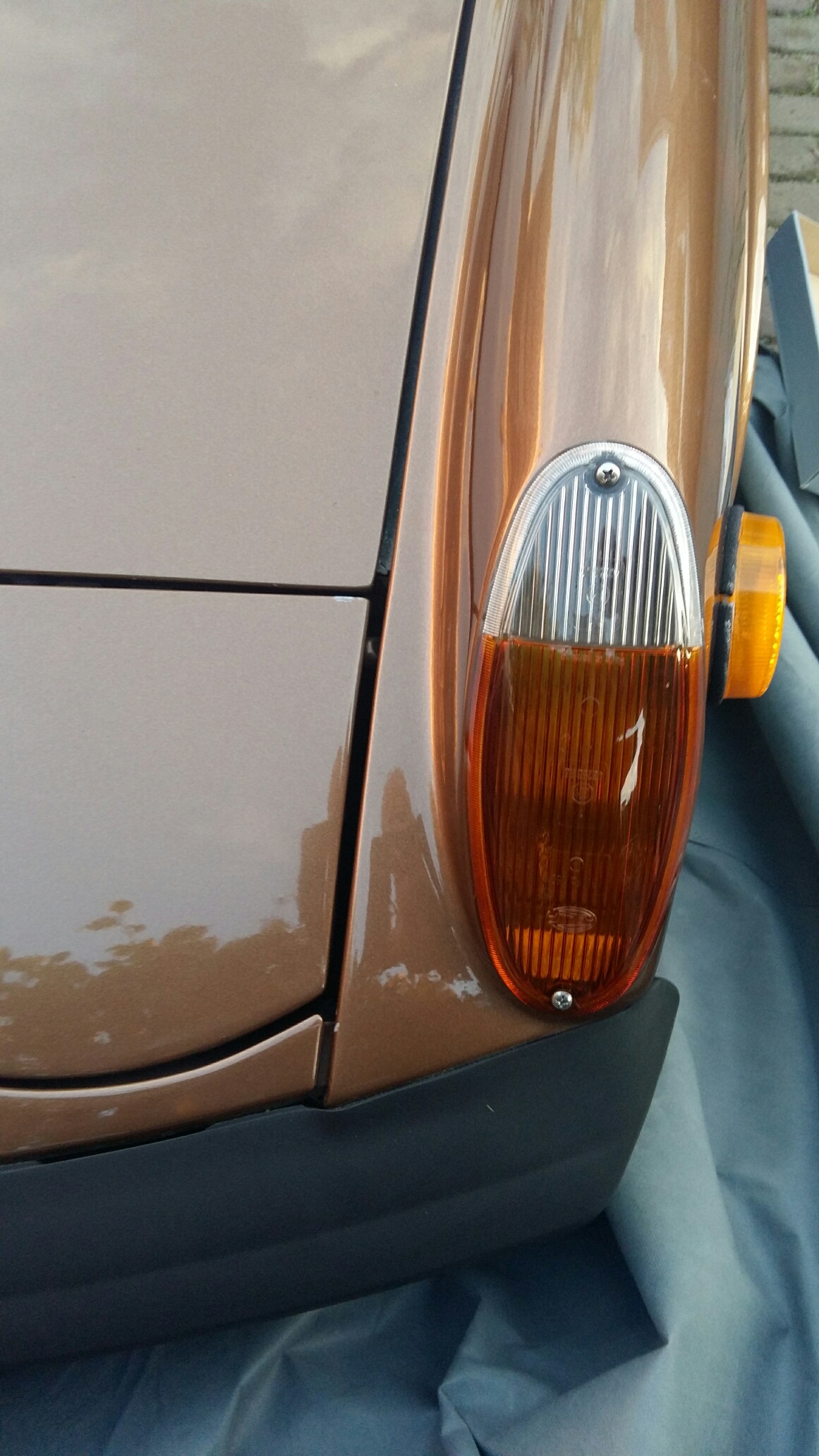

Ok, so I am busy prepping the 914 for the Dutch test by the DMV (called RDW over here) where they will test Identity, structure/damage and the feared technical test where all must work incl the smallest light, wiper and horn etc.
The lights had some issues, I solved that, but next were the drivinglights. I thought I had to disconnect them, but we checked regulations and it is not stated it is not allowed. It is not allowed to project orange light to the back it sais, which it does not really since it is on the fromt/side. So I found some nice driverlights and mounted them (old ones were cracked, rubber too far gone)
Next were the lights in the turnsignal lens. I am not allowed to project orange light to the front while driving, which they do. I thought an easy solution for the test was to turn them around like this:
But they do project orange glow anyway on the front of the car while they are mounted upside-down, not allowed, so not an option. We also found out that indicator light color can either be orange or yellow as long as they do not stay on while driving. OR...white ! which can also stay on while driving....
So...I bought clear lenses on evilbay and I think that solves the issue for the test, since I have no colored light on the front (white stays on while driving ) and when using the indicator they stay white (on/off/on) which is allowed according to regulations.
I hope they will accept this, actually my worry is when the indicator goes on/off/on/off...in blinkmode when off I have no white drivinglight in this setup...and I should have a drivinglight...I think I can show them I tried to take action and am serious....the instructions are not so clear on this....we will see at the test later. But thinking about it...I do have a driving light when the indicator is in use...the orange one on the side ! well....I guess I have to wait what the judge will say....
Another thing off the to-do list.....one small step closer to book the test ....
