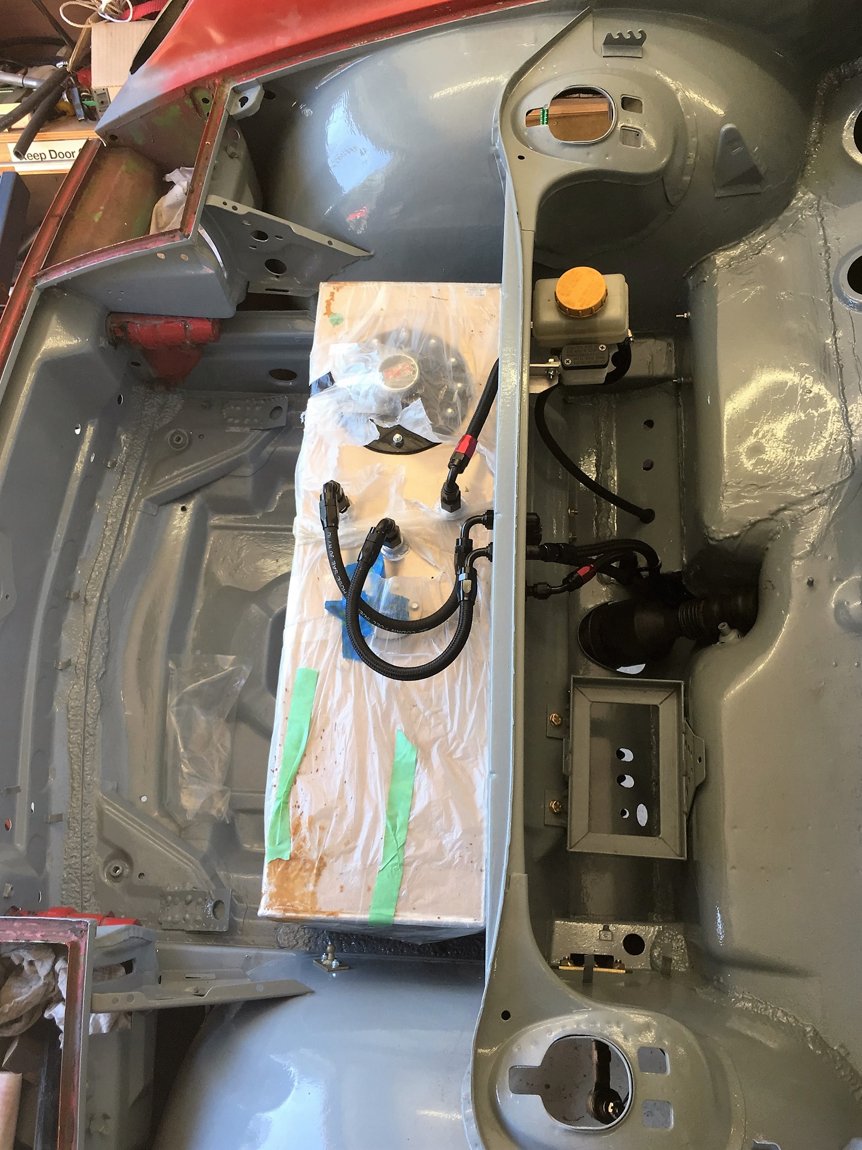

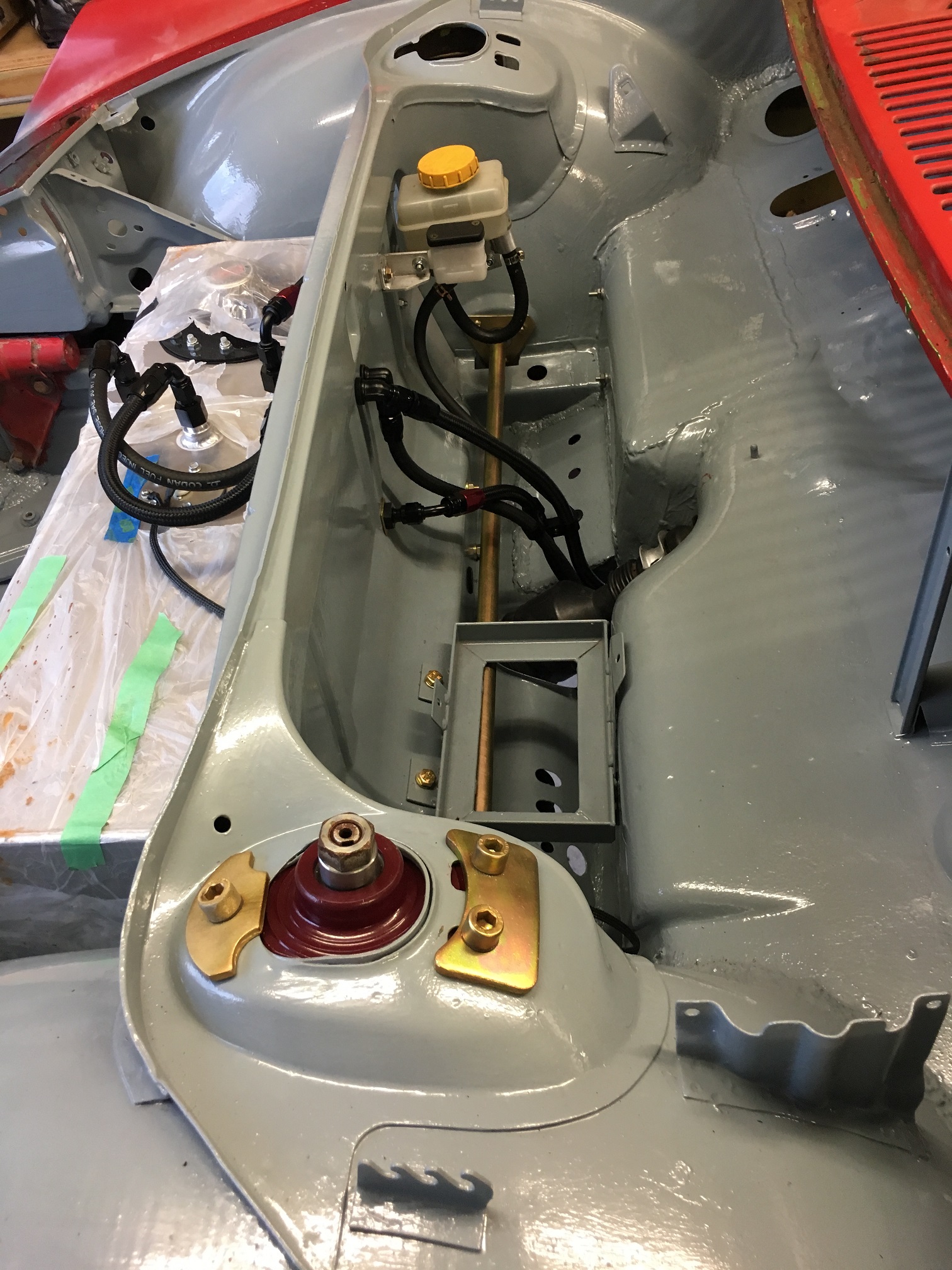

got the inside of the front end close to being complete - still a few more things to tidy up in there, but all the heavy lifting is done there.
suspension & steering rack installed - fuel systems all done, just need to lay the remaining hoses down the spine to the engine bay - that'll keep for the 'middle' work tho.
anti roll bar & wheel well strengthening plates welded in & sealed up.
additional camber plates for front shock towers installed, well at least one side is.

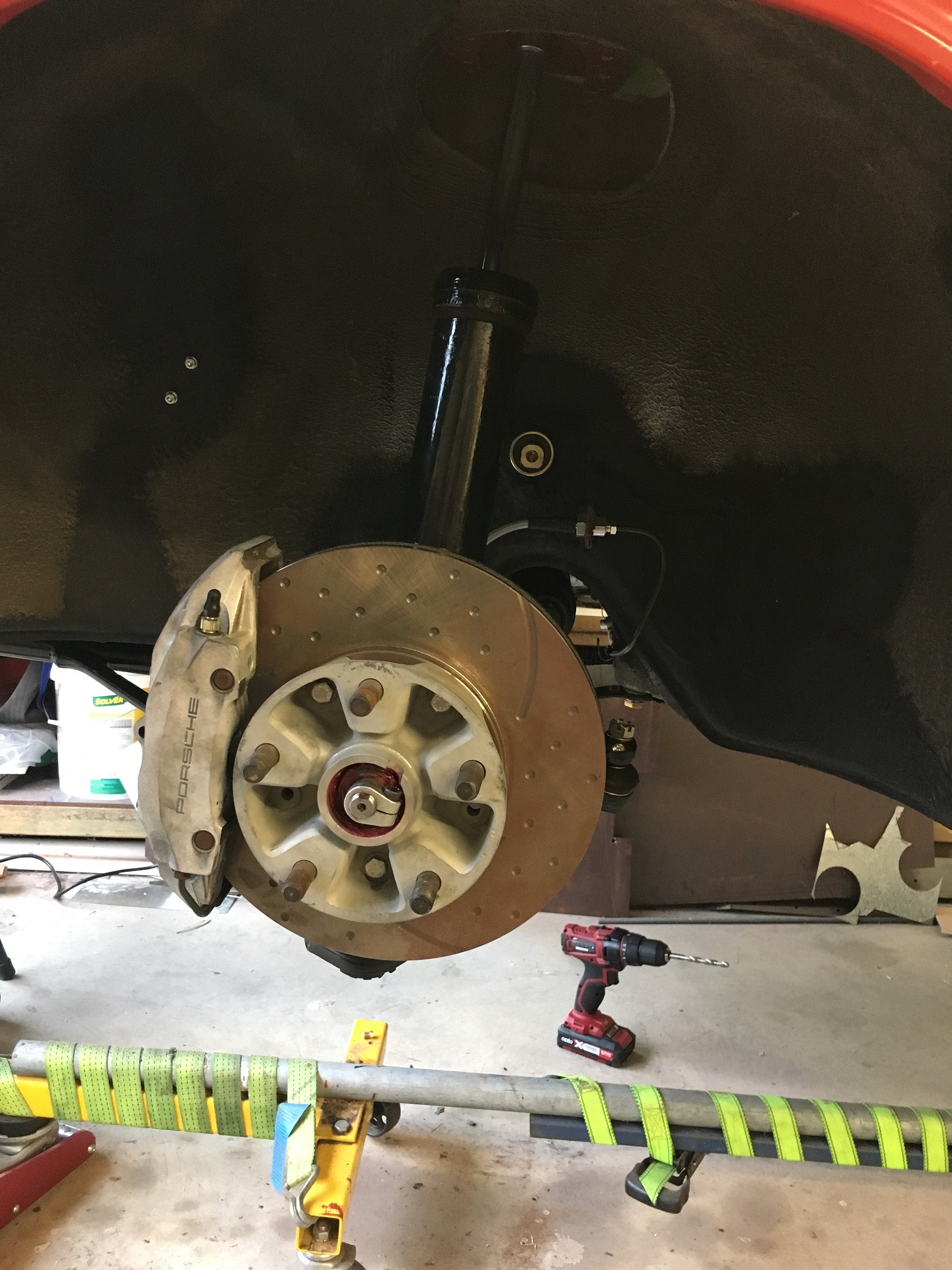

front struts reconditioned, boge shocks, 22mm torsion bars, boxster calipers & brake lines installed. I used the rebel racing boxster caliper 'kit' and sourced my own calipers. the start of brake lines are fabricated.
battery tray bracket fabricated & installed - just need to weld in an earthing strap bolt.
brake & clutch fluid mounts fabricated & installed.
fuel pump sits as low as I could get it behind the fuel tank. bosch 044.

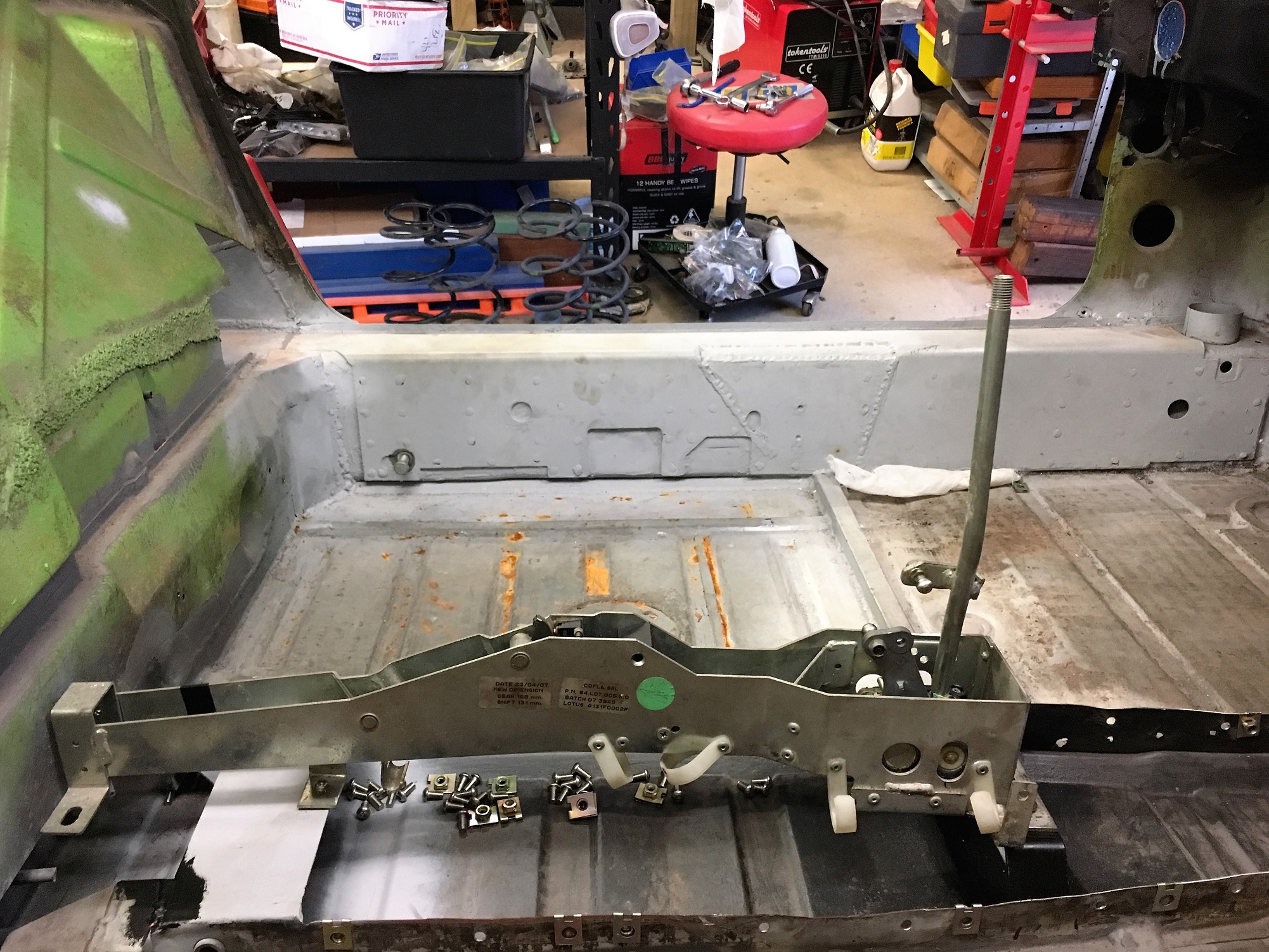

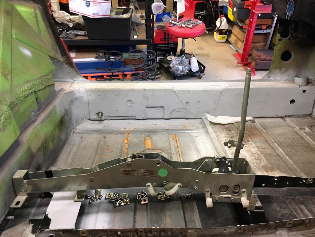

the lotus shifter & handbrake mechanism is mounted and covers are completed for the centre tunnel.
dbw pedal & linkages installed - still need to play with the rod length.
