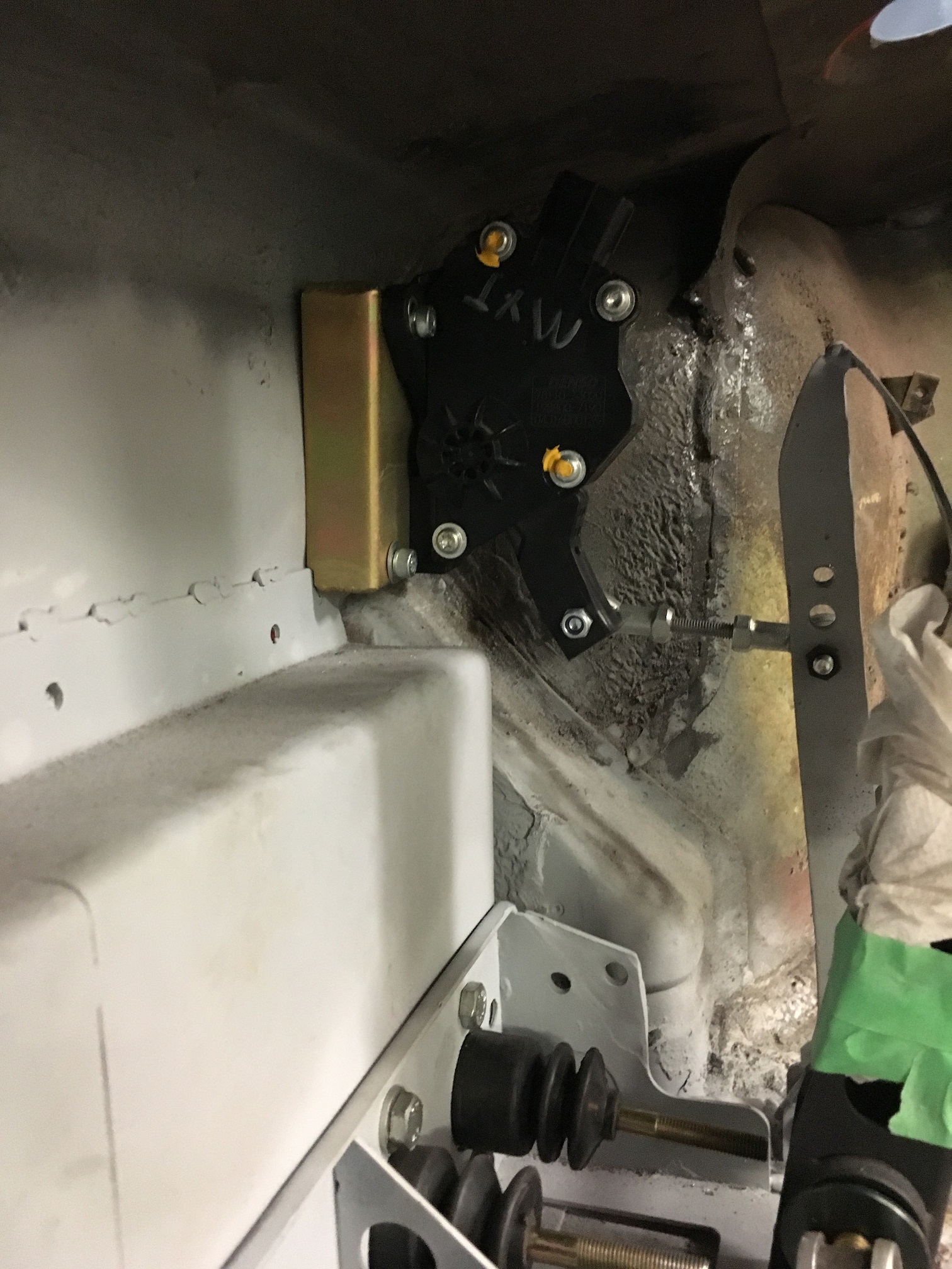

barrym   Because I'm switching to electronic throttle o...   Sep 5 2016, 02:35 AM
barrym   been doing a little work on the throttle body - wa...   Sep 9 2016, 05:20 PM
barrym   i'll also add that you have to fool the coroll...   Sep 9 2016, 06:32 PM
barrym   hmm - slight change in plans for the TPS to the Su...   Sep 11 2016, 01:34 AM

jd74914   It looks great Barry! That Corolla pedal is e...   Oct 11 2016, 09:17 AM
barrym   Thanks ! The pedal actually from an '07 Ca...   Oct 11 2016, 04:23 PM
