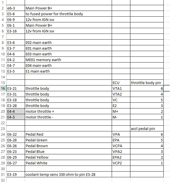

sure - i'm pretty sure this is the final xls I ended up mapping out ... its not hard to lookup the corolla manuals and work out what needs to go where ...
take a look at the pic - the gold coloured box is made up to space out the pedal from the firewall ... just a bit of sheet metal folded, welded & zinc coated ..
