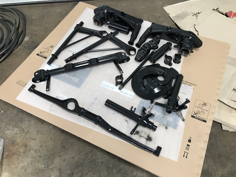

aggiezig
post Oct 17 2016, 04:51 PM
Porsche Wannabe
Posts: 321
Joined: 13-January 16
From: Austin, TX
Member No.: 19,557
Picked up some shiny clean parts today...
(IMG:http://www.914world.com/bbs2/uploads_offsite/i120.photobucket.com-19557-1476744706.1.jpg)
