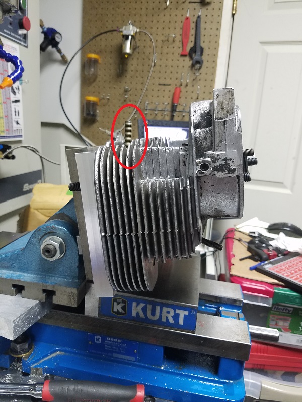

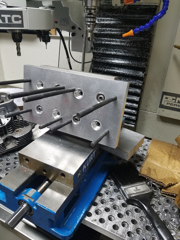

Anyway, back to some small progress. Recently received my new lifters, chromoly push rods and all the assembly lube and seal material sold by The Type IV store, I think I should replace my springs so I will bump my engine build thread for that question.
I made a plate to bolt my heads to so that I can mill out the broken exhaust studs.
The stud circled in red is just for a quick reference, I'll make sure the stud holes are aligned near perfect before milling and tapping.
