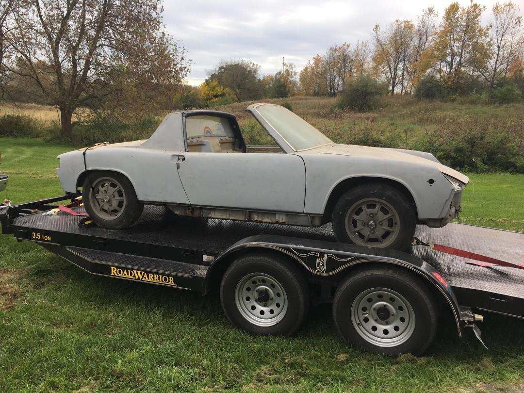

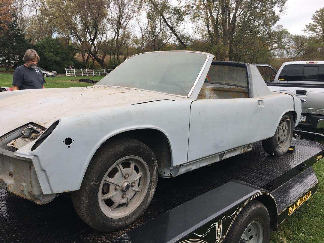

Ok so a little update..
My dad's car was picked up today and is being delivered. Its a 74 2.0.. Not much rust but some I will have to fix.. It has been bare metals and primed but needs to be cleaned up.. It cost zero dollars to buy so the price was right..
Once it's running I will work with him on some sort of clutch actuator..Attached Image Attached Image
