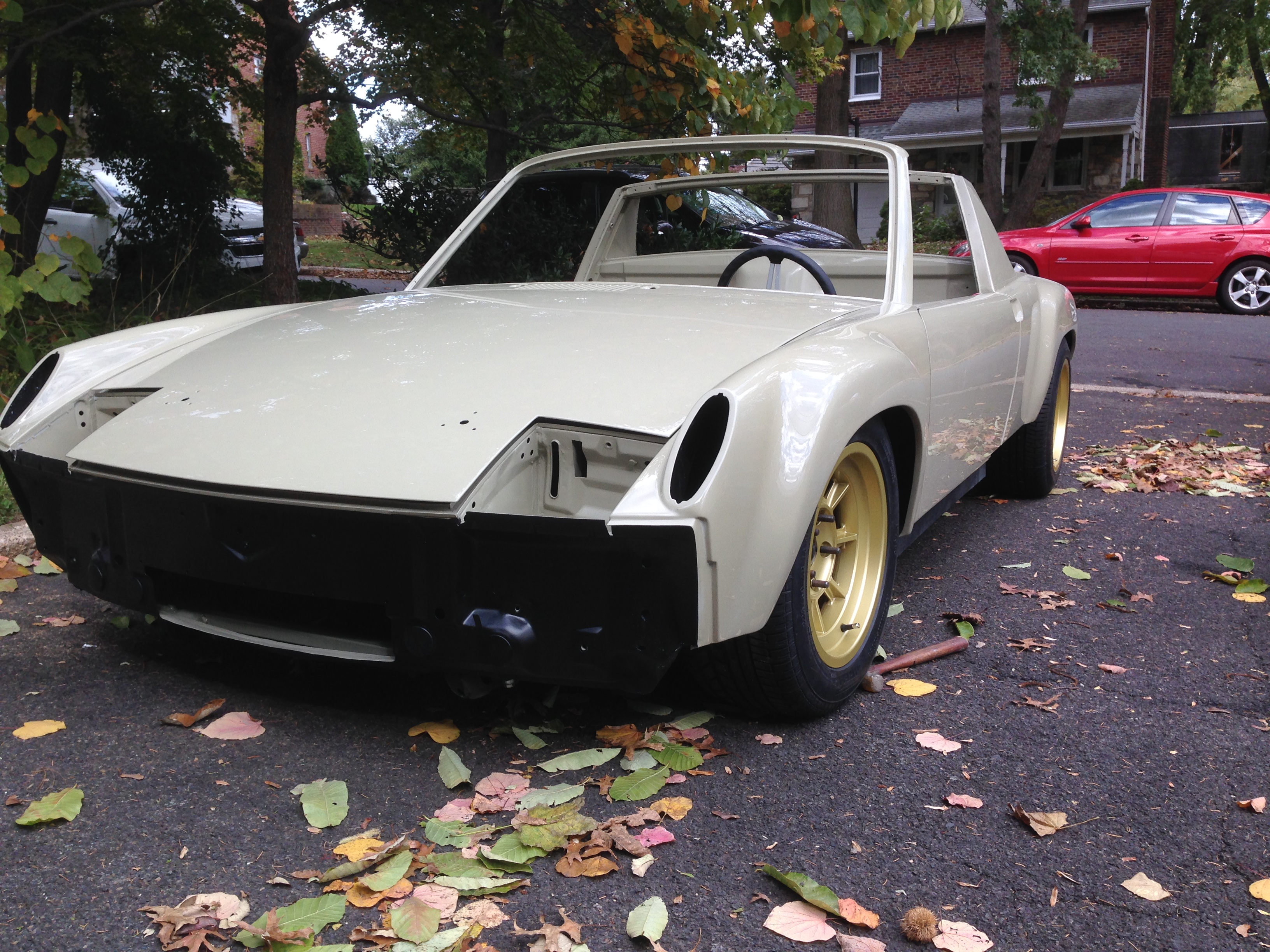

914dave   It been a while for updates. I have a new respect ...   Oct 19 2016, 08:29 PM
Dion   :driving: soon baby soon!   Oct 19 2016, 09:38 PM
rgalla9146   Hey Dave The car looks fantastic ! ...   Oct 19 2016, 09:46 PM
914dave   Hey Dave The car looks fantastic ! ...   Oct 20 2016, 06:32 AM
Larmo63   Wow!!!! That looks great!...   Oct 19 2016, 10:52 PM
jkb944t   It is really looking nice! Jeff B   Oct 20 2016, 05:53 AM
