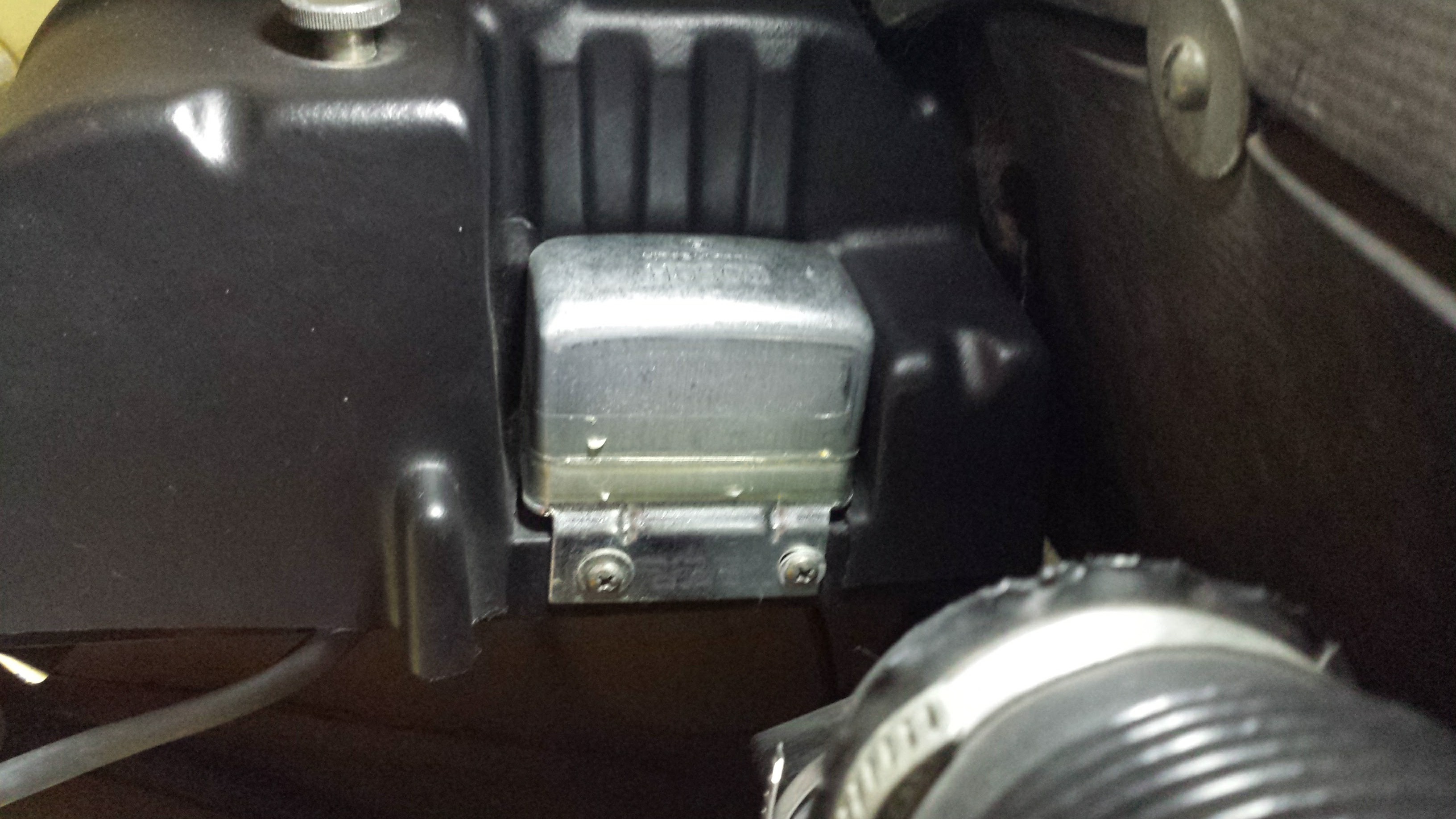

Here's a pic of the half height, transistorized Bosch regulator installed in my car. Fit was no issue.
