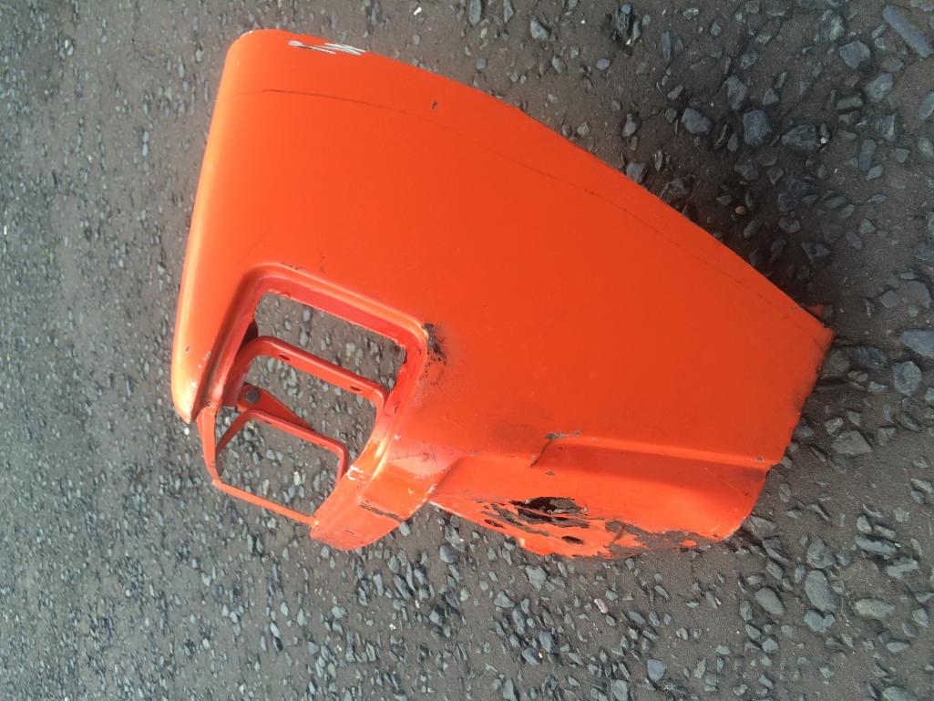

Nutter965   This is the front damage look like it was run up o...   Oct 1 2015, 02:25 PM
