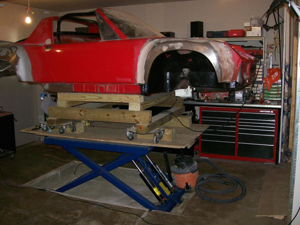

Hey guys (and gals). I know there are some older threads on this, but I am looking for a car lift that can go ~40" lift, doesn't need wooden ramps (for a 914) and doesn't break the bank. This Atlas lift from greg smith seems to come with shipping for $1745. Does anyone have this lift or something similar?

Just another shot, 914 on wood dolly on top of wood lift cover. Was great at getting to all the tough spots before repaint. MarkAttached Image
