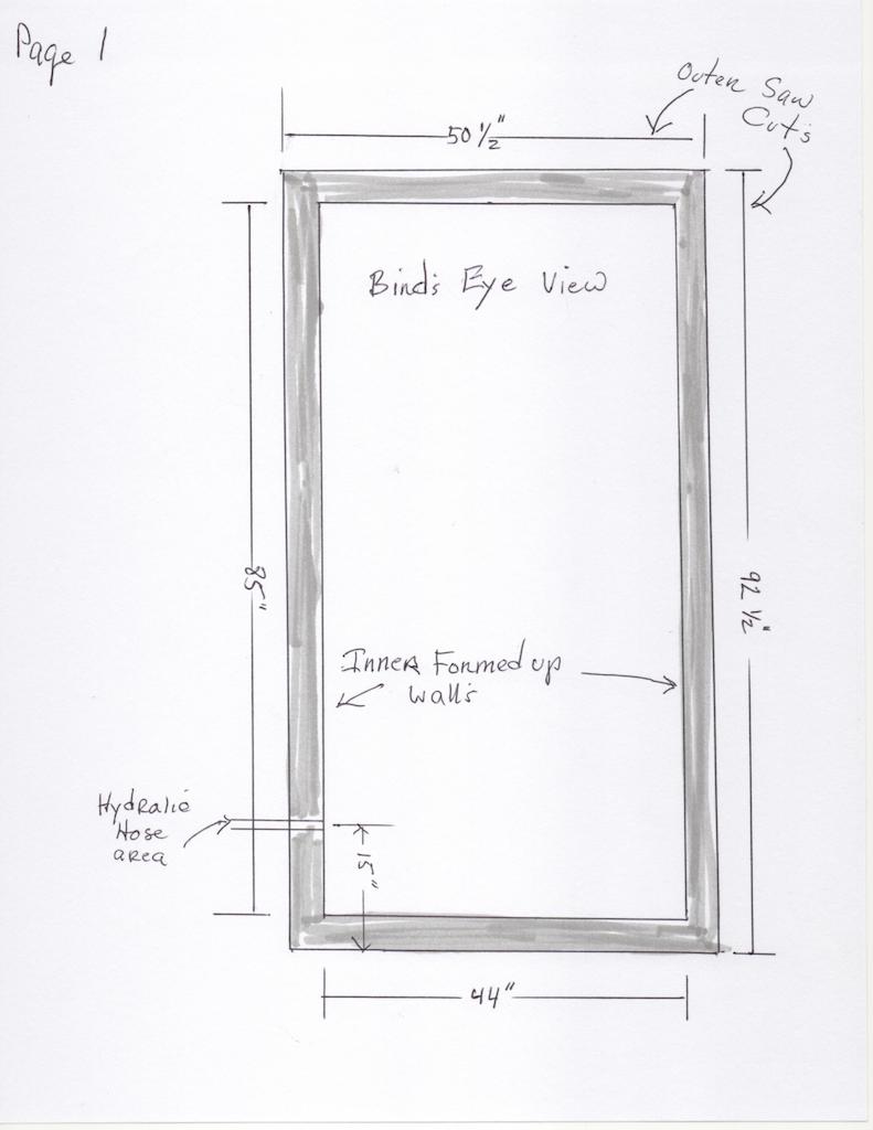

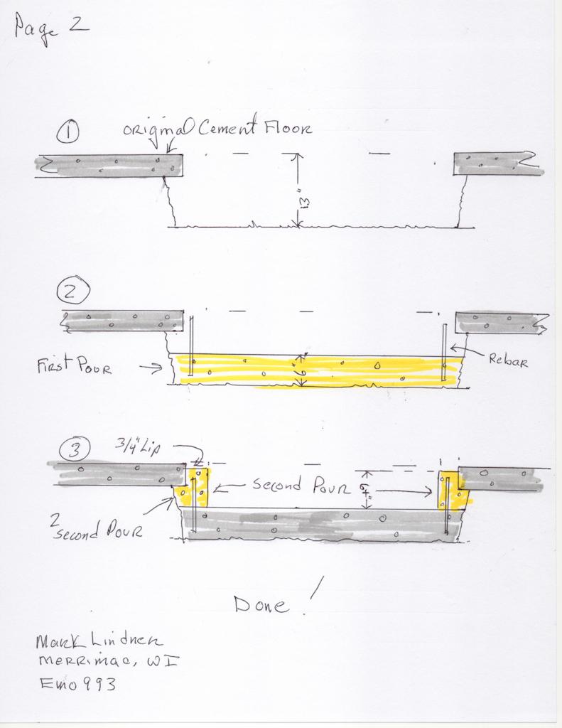

Hope this works, again this schematic is for my BenPak, but is the same size as most. Best, MarkAttached Image Attached Image

mlindner   The old cement floor was only 3 1/2 inches thick w...   Oct 29 2016, 12:54 PM
Harpo   Did you tie the old cement to the new cement using...   Oct 29 2016, 03:47 PM
mlindner   Hi David, no, no need for that. The base for the l...   Oct 29 2016, 04:33 PM

mlindner   Justinp71, back to your question. Looked over the ...   Oct 30 2016, 09:04 AM
