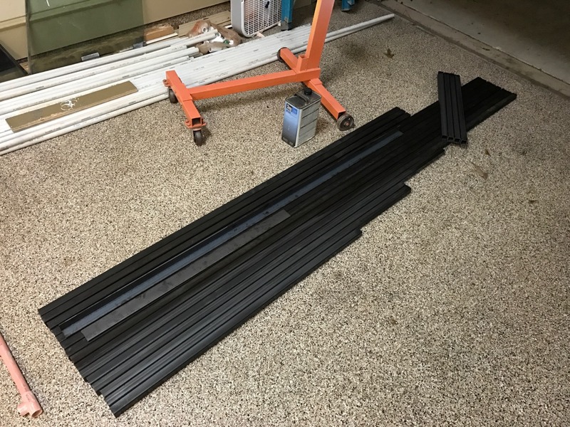

I had a hard time coming across the CAD plans for this stand but finally found them in the above thread. For anyone looking for these plans... download this PDF of all four images combined together.
Here's all of the required metal:

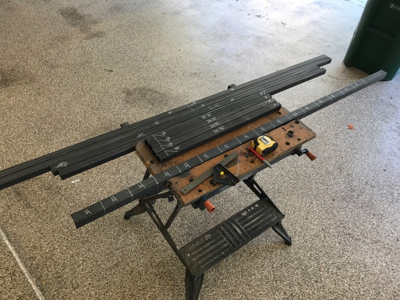

Marked up for cuts:
(IMG:http://www.914world.com/bbs2/uploads_offsite/i120.photobucket.com-19557-1477884570.2.jpg)

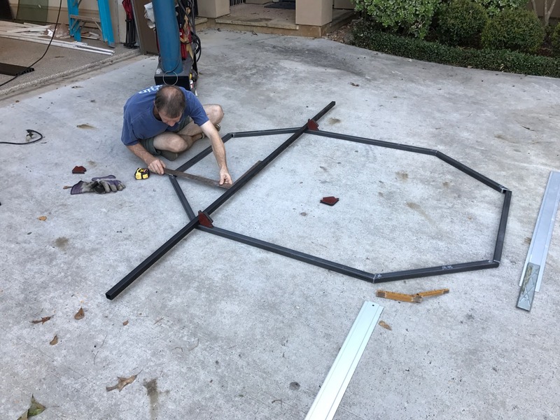

Dad helped out with some smart ways to square it all up:
(IMG:http://www.914world.com/bbs2/uploads_offsite/i120.photobucket.com-19557-1477884570.3.jpg)

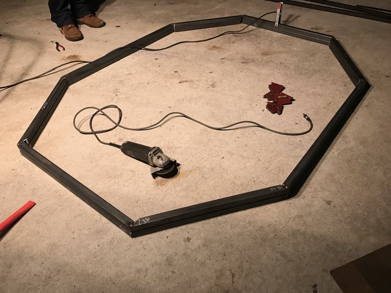

Using the bottom hoop as a template for the top:
(IMG:http://www.914world.com/bbs2/uploads_offsite/i120.photobucket.com-19557-1477884570.4.jpg)

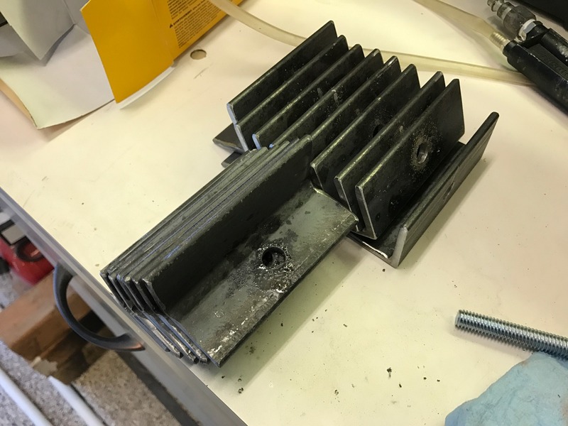

I started to prep the angle iron for the brackets for the 8 connecting bars but that's about where we stopped tonight.
(IMG:http://www.914world.com/bbs2/uploads_offsite/i120.photobucket.com-19557-1477884571.5.jpg)
Hopefully we will finish up the stand this week and possibly get the car mounted in the stand this weekend. I may deviate slightly from the RD drawings as I do not want to re-mount my clean, powder-coated suspension crossmember under the car. I will likely use a piece of 1-1/4" square tubing that's left over and extend the height of the front "pick-ups" off of the hoop.
