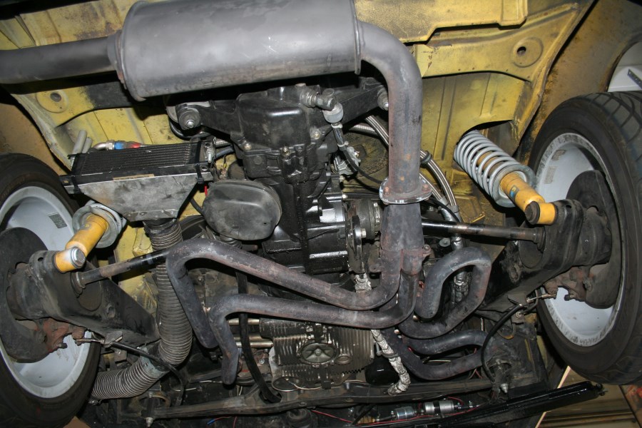

I can't locate the post; but someone was asking about mounting the front auxiliary cooler for a 6/ conversion project. I had responded about an alternative that involves mounting a cooler and cooling fan in the engine bay of a 914. I have attached several pictures of such an installation. This was not my car; however, my installation was essentially the same as depicted in the attached photos.
The cooler and fan carried a price tag of less than $400. To install the cooler, you have to fabricate some brackets as shown in the pictures. You'll need to route 12 volts to the cooler which incorporates a thermostatic temperature switch to actuate the booster cooling fan when oil temperatures reach a predetermined point. You'll also have to fabricate two short jumper hoses to take suction from the engine mounted oil cooler.
There are a number of these installations out there, including the one in my car. Several are running down in Dallas and work well.
Installing this rear mounted cooler deletes the need for hoses to be routed to the front of the car, and for body modifications needed to mount an oil cooler in the front trunk. The cooler is available from Savage, or from any number of suppliers.

Here's mine. Fans work great when you're stuck in traffic but restrict the flow of air when they are not running. If you often find yourself in heavy bumper to bumper traffic, a fan might be a good idea though. However my next project will be a front mounted cooler. (IMG:style_emoticons/default/biggrin.gif) Mostly because I've just about run out of things to do to the car. (IMG:style_emoticons/default/laugh.gif)

Isn't yours a 4,yes it is ,I think the cooler needs to be set up @ right angles to the truck floor to get flow,wouldn't the fan be working overtime if not mounted that way?
My cars already cut up front which is a pain I need a piece of panel to weld in,car originally was set up for a 3.0.
