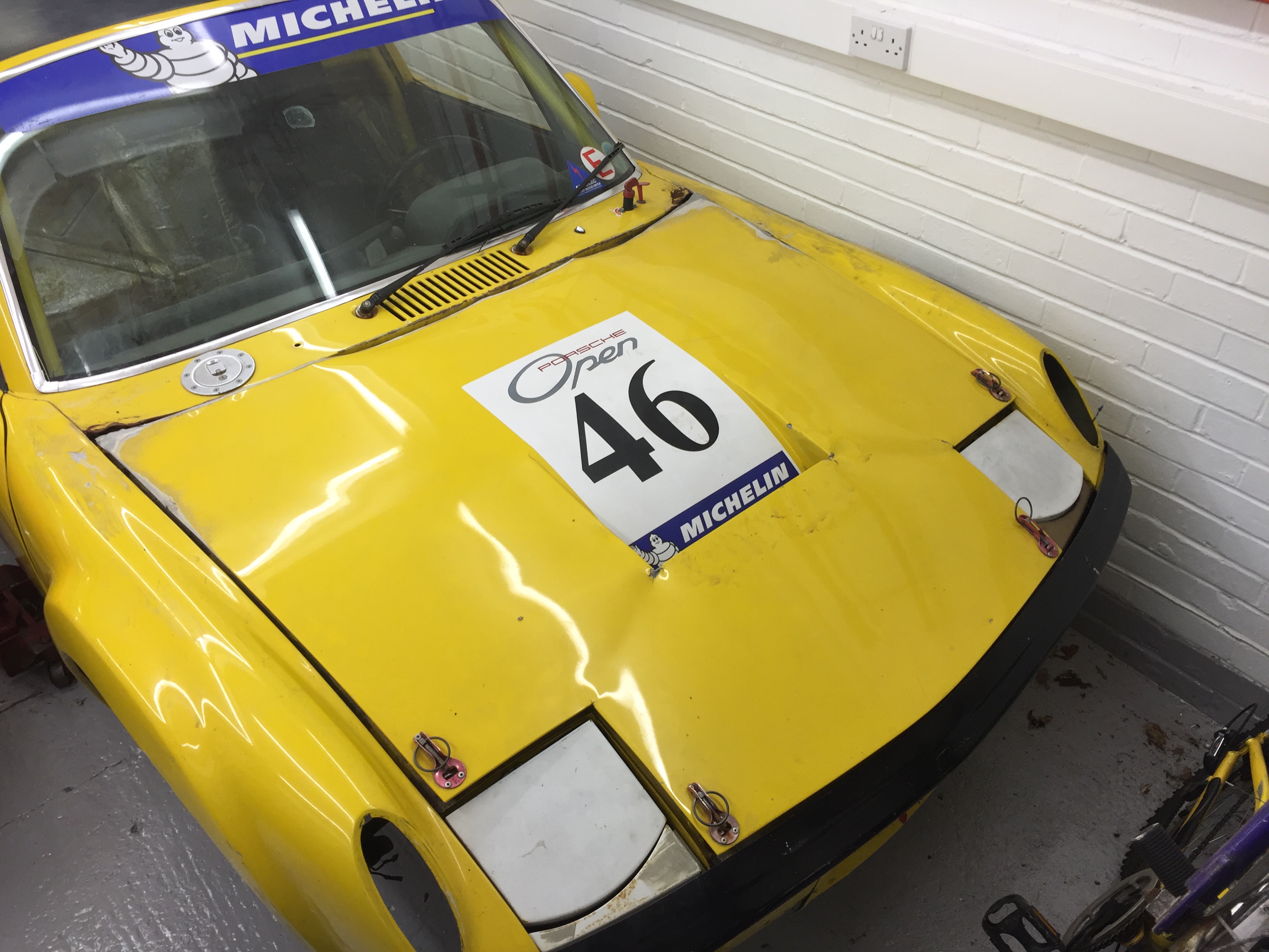

I like the idea of a rear cooler on the grounds of clean lines, but far from convinced in its effectiveness in comparison to traditional front mount. The factory had lots of experience with what was effective and what was not
If you are going to do a front cooler don't do what my cars PO did and cut a hole in the front then vent out the hood without a well fitting ducting solution
A) it looks (IMG:style_emoticons/default/barf.gif)
B) when traveling at speed, hood hinges cut through windscreen slam panels really well once the hood goes
(IMG:style_emoticons/default/blowup.gif)
