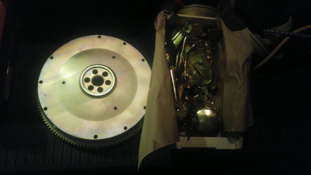

post Nov 4 2016, 04:34 AM
Posts: 7,824
Joined: 2-January 09
From: Burlington wi
Member No.: 9,892
And some parts back from the plater.. I like doing flywheels and brake rotors..Attached Image
