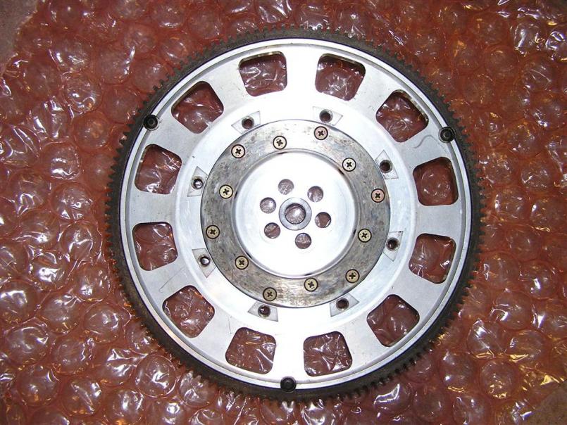

I have a 2270 motor that I will eventually be putting into my '71 with a sideshift tranny, once I get some dress-up and parts collected. It does not currently have a flywheel, clutch, or pressure plate.
1. Is there a benefit to finding a lightened flywheel if the motor has lighter internals?
2. I assume I should use a 6-spring clutch disk or an aftermarket performance material, but maybe this isn't necessary for a 150-HP/TQ motor? Ditto for the pressure plate.

I like lightened flywheels:
