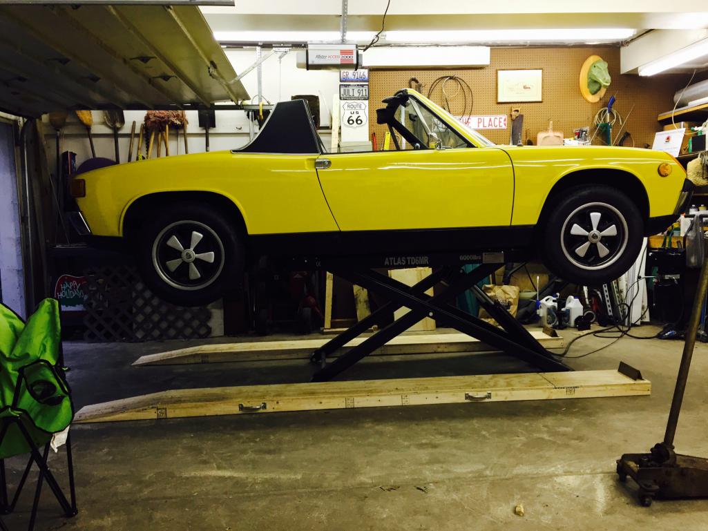

Per Garrold's recommendation, I also purchased one from Greg Smith Equipment a little over a year ago. Making the ramps was easy and mine can be easily moved away if needed. I just wish I had gotten one years ago!Attached Image
